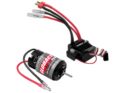

Moving onto the Motor and ESC (Electronic Stability Control). I purchased the motor on its own which was a bad idea because it ends up being much cheaper if you just buy and ESC+Motor combo. Another thing you want to do is get a good quality motor and ESC (this also applies for the servo) these are brains and limbs of your car so if you want to splurge on anything it should be this. Make sure you order the one with the T-plug.

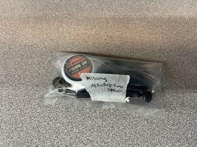

  1. Make sure you take inventory of the the pieces. My package came with 2 missing pieces that were very necessary to the process. It was not that big of a deal for me because Ms. Berbawy had the pieces that I needed replaced but if you don't have access to this then I would recommend letting the company know asap so you can get a partial refund or a new set.
  2. In the first package you will be dealing with some gears. This step is pretty easy except for the oil. DO NOT TRY TO MELT IT. It is very thick but I later found out that it is supposed to be this way. I tried to melt it with a heat gun (do not try this) and the container melted instead of the oil. I eventually just scooped the oil inside and let it sit for about 5 min. This ended up working perfectly fine you just have to be patient.
  3. This next warning is also about a lubricant. The second bag has another lubricant that, in my opinion was harder to deal with than the last one. For this one I just took each individual gear and rolled it in the lubricant which worked great and the gears moved smoothly.

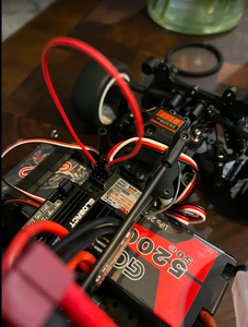

Step 3: Electronics

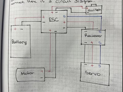

Above is a circuit diagram that I put together to make this process less confusing. Make sure you check your circuit a couple of times before attaching it to a power source because if it is wired wrong there is a very high possibility that you could ruin all of the electronic parts. When connecting the esc and the servo you have to put them into the right channels. The servo is for rotation of the car so it helps you go left and right. This means that that it goes into the steering channel which is channel one. The esc is connected to the motor so it goes into the acceleration channel which is channel 2. Make sure that you put them in the correct channel the correct way or the car will not run. If you switch the 2 then you'll end up with the acceleration button steering and the steering button controlling acceleration which will make it a bit confusing. When you connect the battery make sure that it is fully charged or it might not work. You may need a lipo battery charger to charge it because it requires a special charger and most of the time the battery does not come fully charged. If you do not have access to this you can find it here. Make sure it has a T-plug charging cable. Once you are all done with the wiring put the battery in the slot for the battery and attach a velcro patch to the far side of the battery pack so that it can be taken out to charge.
