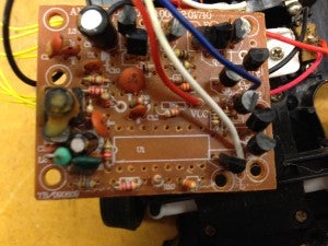

You need to take apart your RC car and take the IC off the circuit board. You can do this with a pair of pliers, soldering iron or a solder remover.
Step 2: Connect the Arduino to the RC Cars Circuit Board.
Once you have done that you need to get a length of rainbow cord with four wires about 10cm or more and connect a pin for each wire. On the opposite end you need to connect four resisters to each wire again and that will then be soldered on the circuit board where the IC went. You need to locate the forward, reverse, left and right hole on the circuit and that will be where the resisters will be attached. The other end with the pins is how the Arduino will be connected to the car. You also need a wire that connects on the earth on the Cars circuit board which will then go on one of the grounds on the Arduino.
