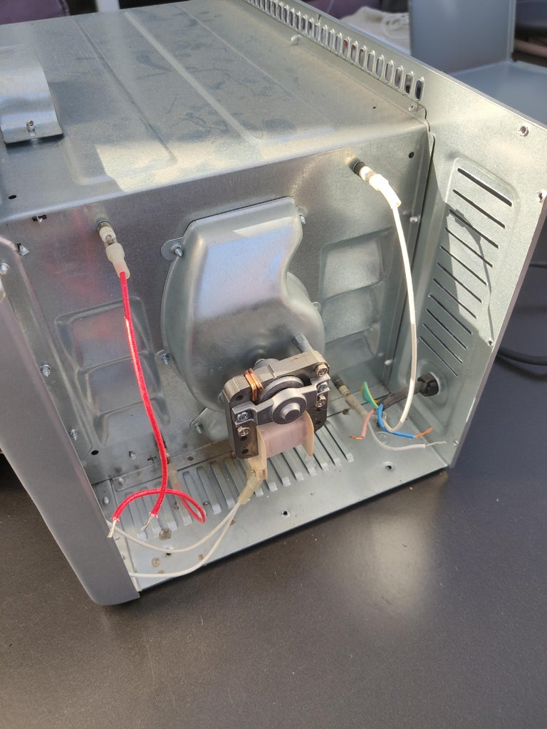

Step 2: Remove All the Electronics From the Oven
At first you will need to remove everything of the old electronics from the oven. Take care about the sharp edges from the sheet metal!

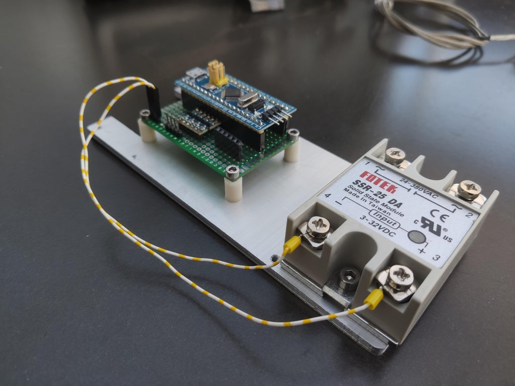

Step 4: Build the Electronics
The electronics of the reflow oven is really simple. It is just a STM32 Bluepill board, with a MAX6675 thermocouple module, a Nextion 3.5" display and a solid state relay. You will find the schematic above. The level shifter in front of the nextion display is required, beacuse the STM32 works with 3.3V and the Nextion with 5V. I have mounted the electronics on a 3mm Aluminum sheet.

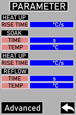

If you press on the Settings Button, you will be forwarded to the Parameters Page. There you can define all the Settings for the Profile

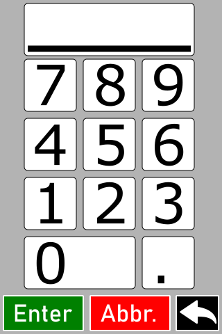

The Last Page is the KeyPad. The KeyPad will be opened when you press on the red Button of the Parameters

The GPIO Pin for the Relay
To adjust the Output Power of the Heater I have used a Solid State Relay. While working with SSR Relays, you should know that they are often build with Triacs as switching Unit. This means that the SSR can only switch off when the Current is zero. The Heater is Controlled by 230 V 50 Hz Main Voltage so I have to switch way slower than 50 Hz for an better power control. So have set the PWM Frequecy on Pin PA9 to 1 Hz. That way, I could simply adjust the power by the dutycycle on Pin PA9.
