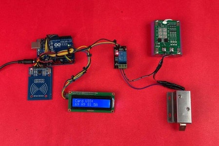

Step 2: Make Your Hands Get Dirty While Setting Up Our Hardware
For complete video guide for setup and working demonstration, check out this link - https://www.youtube.com/watch?v=PeGIjCImpE0
As you can see the hardware connections are pretty easy and straightforward. This set-up is powered buy a 12V lithium battery pack making the project portable and easy to install, For practical purpose, you can opt for 12V adapter.

Step 5: Lets Test Our RFID Door Lock System
At last, we've entered the most exciting phase, i.e final testing of our RFID Door Lock System using Arduino!. In the above images, you can see that, after scanning the Authorized RFID tag, it granted access and make the solenoid Door lock to get Unlocked.
