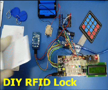

Step 1: [Device Overview] Reyax RYRR10S RFID/NFC Module - I
We have made detailed review video about RYRR10S RFID/NFC Module. We have explicated in detail about its Features, specifications, configuration guide, application Interface, Datasheet and AT commands Guide
Step 2: DIY Project - Two Level RFID Lock
Now, lets see one small DIY project using this RYRR10S RFID reader module. Which will be having, two levels or layers, of locking system. In which, user have to use valid RFID card to unlock the Lock. You can see below is the functional block diagram of the project. It consist of, RFID module and Keypad as an input.
Detailed circuit diagram is given below, you can also get it from GitHub Repo of the project.
There will be Two levels or layers of authentication. One will be, of course, the RFID and other one will be Passcode. If both levels completed successfully, then and only then, lock will get unlock. So, in order to enter pass code, the matrix keypad will be used. Here, we will see, two different programs. Two different versions of this DIY project.
Step 3: DIY Project Version 1
  • First version, will be simple and basic in which all the authorized users data. Means, their RFID’s and their respective passcodes are pre-programmed at the time of programming. User can not change it afterwards in application mode.
  • RFID will be the first level of authentication and triggering point for this version of project. System will be continuously scanning for RFID card or tag to be placed on RYRR10S Reader
  • If suppose, user places his RFID card on the reader. System will detect it. read its UID. unique Identification code, specific to that card. And then, compare it with Authorized cards, available in the database, which we have saved into microcontroller, at the time of programming. If it is found that, card’s UID is Valid and authorized, then and only then, it will goes to next level. Other wise, it will display access denied, on the LCD screen and will go back to its home screen. Lock will remain locked.
  • In another case, suppose, If system finds RFID card's UID is valid and the authorized one. Then, it goes to next level or layer of authentication. Which is nothing but, the pass code method. Here, using 4x4 matrix keypad, user have to enter the correct pass code. This passcode will also be unique to each user. So, if user has Valid RFID and enters correct passcode, only then, Lock will get opened. Otherwise not.
Step 4: DIY Project Version 2
  • In second version of this DIY project, We will use keypad as an HMI device to interact with the project. Means, using Keypad and LCD display user can set up or configure the lock's settings. Like adding or enrolling new user RFID. Then, we also can delete or reset all the data, by entering specific code using keypad.
  • Here, in this version, like previous one, Both methods or layers of unlocking, will be used. But, the first stage will be the Entering the code, instead of RFID. Here, as we said earlier, We will use keypad, as an HMI device, to interact with the project. Means, using Keypad, and, LCD display, user can set up the Lock configuration. Like, adding, or, enrolling new user RFID. Then, we can also delete, or, reset all the data, by just entering specific code using keypad
  • There will be three main program flows. Like First, in which user enters his passcode to enter into second stage, which will be RFID. If he enters correct passcode, then he will be asked to place his RFID card on the Reader. And if that card also valid, and, authorized, only then, lock will get unlocked. Other two codes or program flows, will be for resetting the user data and adding enrolling new user. Here, UID of new user will be stored into EPROM memory of Arduino, hence, even though power goes off, all the user data will be stored safely.
  • User has to enter specific code, to enter into these modes. Reset and the Enroll modes. You can change these codes, and their digits or characters, in the main program.
