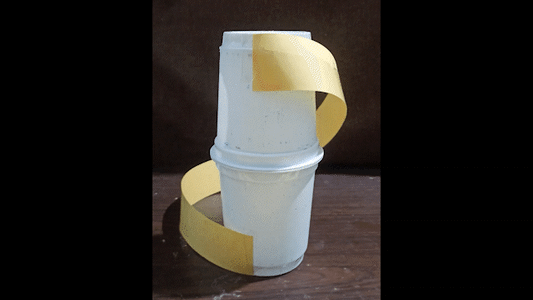

Step 1: Creating the Base
Take two identical cups, clear the bottom face of one, place them together one over the other and glue them together, divide the bottom face of cup into 12 equal parts.
Step 2: Add Paper Strips to the Base
Take length of the strips as twice the length of the cup structure, and width 4 cm would be enough, attach strips one by one at a time, make sure to end the strip in same line at which head of the strip is started (i.e. head and tail of the strips must be in same line), repeat this pattern for next strips and so on, to complete the lamp body.
