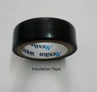

16. Insulation Tape, Scissor & Hot Glue Gun
