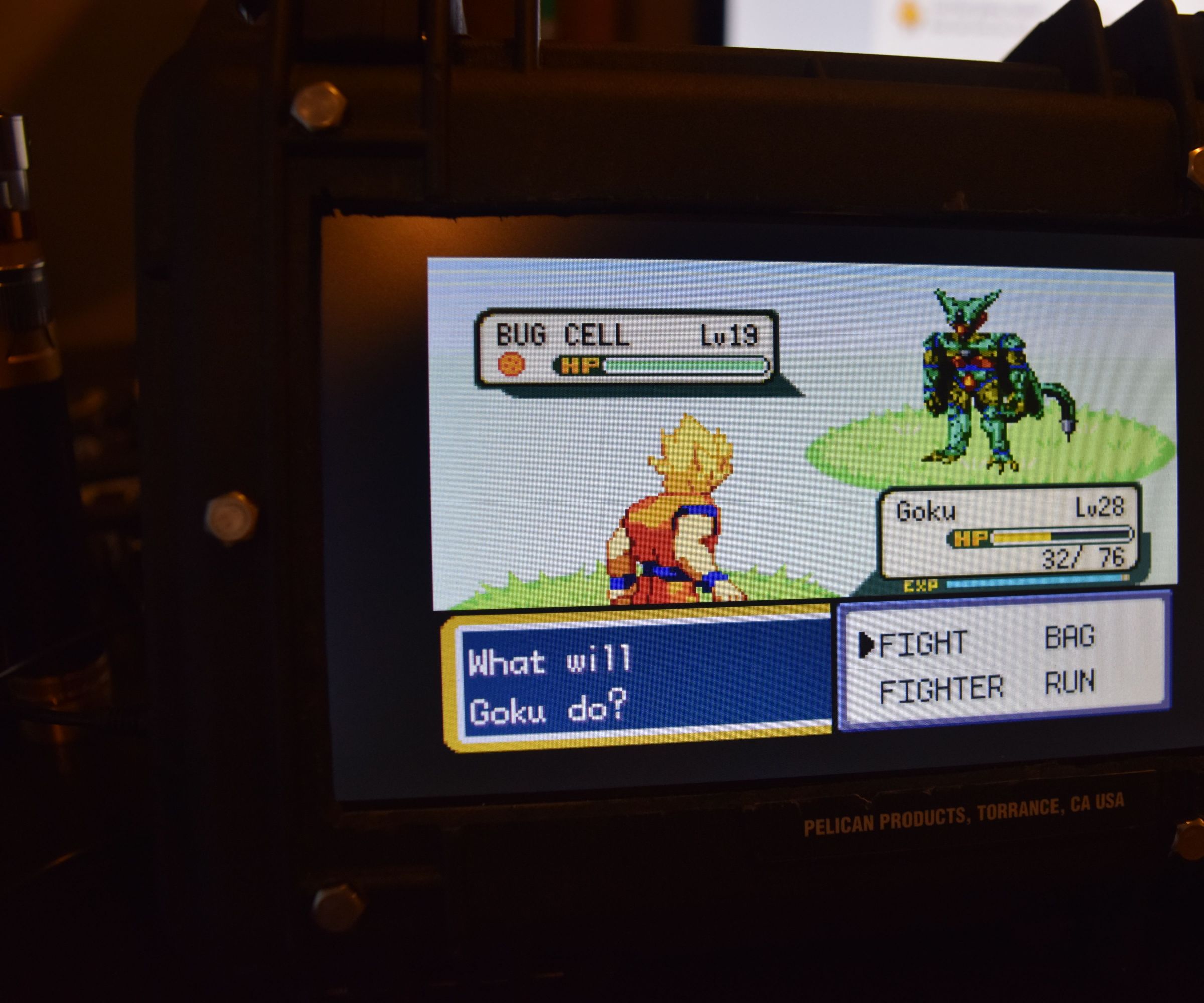

This is my custom built Raspberry Pi 3 Gaming Station I built into a Pelican case I had left over from my boombox projects.Inside the case is the Raspberry Pi 3, a 10.1" screen adhered to a 2mm thick piece of plexiglass, a DC converter board to bring down the power from 19v to 5v, a small 6w audio board, 2 hifi speakers, and a spare laptop charger for the power supply. This took me roughly 3 days to build from start to finish as the cutting of the plexiglass was very long and tedious work as it had a tendency to shatter with too much pressure.

Step 2: Fitting the Screen
The screen was fairly easy to install in the box. As you can see, it's attached to a 2mm piece of plexiglass by way of double sided tape. The hardest part is going to be cutting the plexiglass and making sure it fits inside the lid of the case but not too tight as to cause bowing. After I was finished cutting, I adhered the screen and then carefully drilled 4 holes to hold it in place on the lid.
Step 3: Polish/Clean Up and Enjoy
It's an easy project to do if you have the right tools. I used a Dremel and a Drill for the most part. If you have patience this is a very easy and fun project to do, I'll link my YouTube video below that goes into greater detail in building it. If you have any questions or would like me to expand upon this instructable then please comment below and I'll add comentary or pictures where need be.
