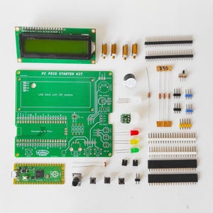

Here are the components that you will need to make Pi Pico Starter Shield:
  • 1 x PCB Pi Pico Starter Kit (PCBWay)
  • 1 x Raspberry Pi Pico board
  • 1 x I2C Character LCD 16x2
  • 1 x Motion sensor PIR AM312
  • 1 x LDR (Photoresistor)
  • 3 x LED 5mm (Red, Green, Yellow)
  • 1 x RGB LED 8mm WS2812
  • 1 x Active BUzzer
  • 2 x Tact Switch 6x6mm
  • 1 x Potentiometer 10K Ohm
  • 3 x Resistor 330 Ohm
  • 1 x Resistor 10K Ohm
  • 4 x M3 10mm Set Spacer Screw
  • 2 x Female Header 20 pin
  • 1 x Male Header 4x20pin, pin, 4x3pin & 5pin
  • 1 x Double Male Header 2 pin
  • 1 x Slide Switch
  • 2 x Jumper cap

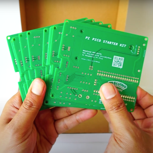

Step 3: Order PCB on PCBWAY
To make this project you need to order a prototype PCB on PCBWAY. How to order is very easy and you will get 10 Pcs PCB for $5 with very great PCB quality.
Step to Order:
1. SignUp/Log in on pcbway.com
2. Open this PCB project link Pi Pico Starter Shield
3. Set PCB order options: min track/spacing 6/6mil, color and select 10 pieces.
4. Click Add to cart.
5. Wait moment for PCB review, then Click Check Out.

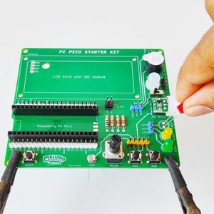

Step 4: Place All of Components
  • Attach the trough hole components on the PCB following the pictures and symbols on the PCB, for details you can follow step by step in the video.

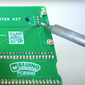

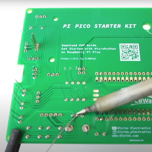

Step 5: Soldering
  • Solder all the component legs on the back of the PCB, for details you can follow step by step in the video.

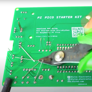

Step 6: Cutting Wire
  • After finish solder, cut all the long legs of the component wire.

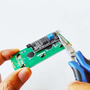

Step 7: Setup LCD 1602 I2C
  • Bend 4 feet of the I2C module so that it is straight.
  • Attach 10mm spacers to the four PCB holes.
Step 8: Install & Soldering LCD 1602 I2C
  • Attach LCD assy to the PCB shield, make sure all the pins of the I2C module are entered.
  • Seolder all pins of I2C module.
  • Then tie it with a nut on the back of the PCB shield.
