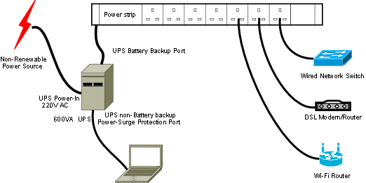

UPS/Inverter: The UPS A/C input is of no use, since we are going to use 100% solar power. This UPS is intended to be used as regular A/C powered backup UPS. When it is connected to the mains, it charges the batteries, as well you can consume via its output. When the A/C supply is cut, it gives the backup power. But if A/C powercord is connected then what is the purpose of this project? So do not connect or use the A/C power source. The UPS came with no battery inside. So I got a 12V 7.6AH Deep-Cycle UPS SMF (sealed maintenance free) battery and installed inside. I soldered 2 cables near the battery terminal and extended outside of the UPS so that it can be connected to the capacitor and to the solar charge controller. The output of the UPS is connected to the powerstrip as shown in the picture. The other lamp output of this UPS is connected to a Lamp extension cord which I got already and connected the 5W LED Lamp to it which I got free with this UPS.

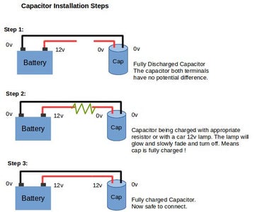

Step 3: Installing Capacitor
You can use any high capacity capacitor. Even you can use a super-capacitor if you got one with appropriate specs. I.e which can support 12v (i.e) a safe max voltage upto 20volts.
Here are the detailed steps which shows you how you can install safely a cap along with a battery in parallel.
