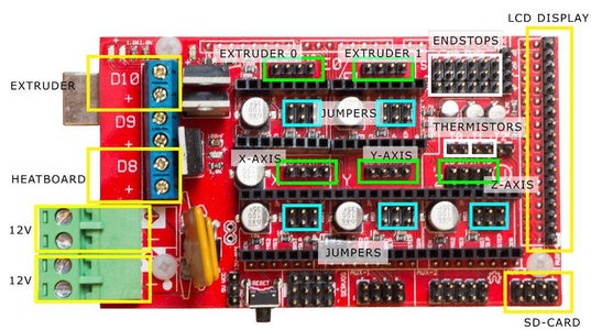

Step 1: Ramps 1.4 Controller Setup
The Ramps 1.4 is an Arduino based 3d printer controller that runs on a 12V DC power supply. Has six stepper motor ports, ports for x, y, and z switches, heated nozzle, part fan, bed , thermistor, and Z probe ports. The image provided is what I used as a wiring guide, I am using a 3D touch and wiring for witch is 3 pin connector to servo port1, and 2 pin connector to z switch port, and I used exclusively 12V fans (just connect the extruder head block fan, and case fan together). I also have the rep rap discount display controller adapter plugged in. I chose to run Marlin as my firmware. Linked below is the configuration file used. You will also need to install and include the U8glib library for certain lcds. After this you should be able to control all the electrical components for the machine.
