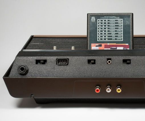

An introduction to Yellowness:
When it comes to computers and video consoles, you really want to keep the original case, even more, that old school case is one of the reasons why is so cool and nostalgic. But, the brown-yellow ish color you see in many old devices is not nostalgic, is basically a layer of matter that got oxidised with time and UV exposure.
Certain old devices were coated with a substance to make them fire-retardant, as they were made using ABS plastic. This layer gets more or less brown depending in what life the device had… Sun or smoke will make them go yellow in the more exposed areas.
