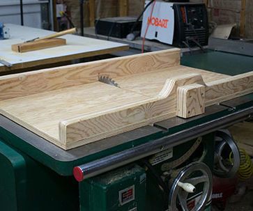

I used a radial arm saw to cut the strips into 11" squares. You could still use the circular saw or jigsaw to accomplish the same task. Or even a cross-cut sled on the tablesaw. Whatever saw you have and are comfortable with should do exactly what you need.
