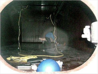

  • Microphone placement is up to your judgement, so experiment! I achieved the best results by placing 2 tube condenser microphones in omnidirectional mode in an ORTF formation, plugged into the two outboard microphone inputs of my flash recorder. This setup worked well both in the center of the room and in the back of the room. You can also use the onboard microphones on your flash recorder, your smartphone's microphone, laptop microphone, or whatever other means of recording you are working with.
  • Set your microphone's input volume low enough that it does not clip (exceeding the maximum volume, resulting in a crackling sound and loss of wave form information) when you create your impulse.
  • Begin recording
  • Blow up your balloon, and stand wherever you choose (directly in front of the microphones is ideal, depending on placement). Allow the room to become as silent as possible. Pop the balloon with a swift motion of the pin, and don't move until the reverberation of your impulse is complete and the room returns to its normal noise floor. Or clap your hands, again, waiting until the room returns to silence.
  • Repeat. Try to be consistent with your impulse generation.

It's really that easy! From there, try adjusting the different parameters inside of the plugin. I found that the gain was a little too high, and I had to notch it down to about -30dB in order to achieve the best sound. The impulse I was using was from a very reverberant space (inside a large metal tank), so there was a lot of reflection going on. In addition to that, the layered vocal track I was applying the reverb to was already pretty loud.
Step 5: Use It!
You can now apply convolution reverb based on any space in which you capture an impulse response! Shower singers and cave drummers rejoice!
Here is a sample so you can here what actually happened when I applied convolution reverb featuring my very own impulse response.
Before and After.
The effect is fairly subtle, but it definitely does sound like I am singing inside of the space I recorded my impulse (a large metal tank).
