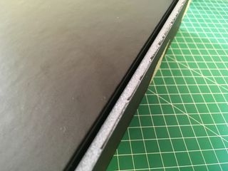

Tip to make long cuts
Sometimes it is difficult to make long cuts because the ruler and the precision knife can slip. The first possibility is to cut with someone else: one holds the ruler, and the other cuts with the precision knife. But if you are alone, another possibility is to use a C-clamp clamping the table, the cutting mat, the material you want to cut and the ruler together. Just hold the other end of the ruler, and cut. (This is the C-clamp I have used).
To avoid
Try to avoid using old blades on your precision knife when cutting foamcore sheets. Because it will more likely tear the foam inside rather than cut. So use a new blade!
