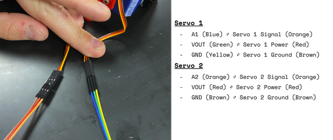

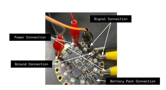

Step 3: Connect Servos to CPX
- Each wire on the servos has a corresponding port it should be connected to, they are as follows:
- Servo 1
- A1 ⇄ Servo 1 Signal (Orange)
- VOUT ⇄ Servo 1 Power (Red)
- GND ⇄ Servo 1 Ground (Brown)
- Servo 2
- A2 ⇄ Servo 2 Signal (Orange)
- 3.3V ⇄ Servo 2 Power (Red)
- GND ⇄ Servo 2 Ground (Brown)

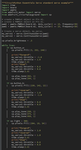

Step 5: Program CPX
This project uses Adafruit's CPX and Servo libraries. An example program is attached below.
The Example Code Includes:
- Light up and drive forward for 2 seconds once button A is pressed
- once the robot stops moving forward the device will sleep for 2 seconds, then play two different tones.
- When Button B is pressed, the CPX device will light up a different color
- Next, the robot will move backwards for two seconds and then pause for two seconds.
- Then, the CPX will produce 3 different tones at different hertz levels.
- Device will acknowledge a flashlight with the light sensor, once the light hits the sensor it will light up a third different color, and then spin the robot in one direction for 3 seconds.

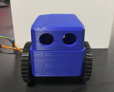

Step 6: Attaching Battery Pack & Final Assembly
- Attach the battery pack to the port on the CPX
- This can then be placed along with the CPX within the body of the robot.
- Finally place the head on top of the other components, it should latch into place.
Step 7: Decorate (Optional)
The robot should be fully operational at this point, but the addition of googly eyes, stickers, or other fun decorations is a great way to add some character.
