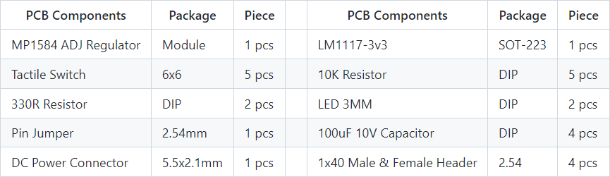

Step 2: Required Hardware and Components
The required components and equipment to be used in this project are as follows.
- 4 X S90 Servo Motor
- 1 X SSD1036 i2c OLED
- Proto Shield PCB & main components(Click for All)

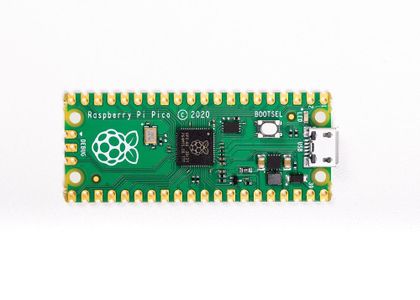

- 1 X Raspberry Pi Pico
Required Tools:
- Soldering Iron
- Soldering Wire
- Micro-USB Cable
- 12V 1~2A DC Power Supply

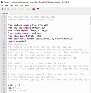

Step 6: Source Code for Snake Game
We don't have any complex connection for Snake game. We will just place the SSD1306 IIC(i2c) screen on the i2c header. Then we download and install the attached code. Also, let's not forget to install the library. If you don't know anything about pico, you can start quickly here; Getting Started Pico...
