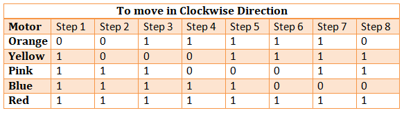

This motor has five wires at the output and if we look at its internal wire diagram we can see that four wires of color, Blue, Pink, Yellow, and Orange are for Four coils and the fifth wire is for +5volts.
To make the stepper motor work, we need to energize its coil alternatively and if we design a circuit then our working code should work according to something like this.
 (refer to image)
Anyways, his was just for explanation, we will be using a library that eliminates this mess by handling it at the backend.

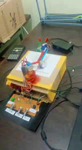

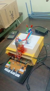

Step 3: Making It
Our robotic arm has three stepper motors at 3 axes.
  • Stepper Motor 1 ----> At the base of our arm to give it rotation
  • Stepper Motor 2 ----> The second joint after the base
  • Stepper Motor 3 ----> The third joint
  • Servo Motor       ----> For the griper of the arm
And three potentiometers were used to control the positions of our motors. For the gripper motor I used two pushbuttons for two functions;
  • Push Button 1 -----à Release ---à Will move the motor to 0 degree
  • Push Button 2 -----à Grab   -----à Will move the motor to 180 degrees

The base motor was supported by two lids ( recovered from old storage containers)
The first lid had a hole to keep the motor in place and was glued together. The second lid had a hole to keep the coupler in place which was made from an old ballpoint. (Check the image attached above)
Second Motor
The second motor was glued with the 4 Cm piece of plastic attached to the base plate.
Third Motor
The third motor was glued to a 6cm piece of plastic which was attached to the second motor and exactly like other motors, this motor’s coupler was also made from Ballpoint.
The last servo motor aka the gripper was attached to the third motor via the same plastic material which was glued to the third motor.
The Griper
I used plastic from an old water bottle and made two holes then passed a piece of wire through them and at one end I tied the wire to two freely moveable parts of plastic while another side of it was tied to a servo motor which was connected to the other side of the plastic.(It was exactly like the 3d model I made and attached above)

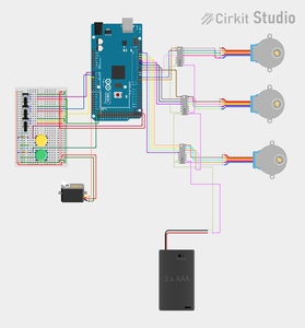

Step 5: Code and Schematics
Circuit Scheme is really simple and everything was connected to Arduino as it's defined in code.
Components like;
  • Potentiometers
  • Push Buttons
  • Servo motor
were powered directly from Arduino 5v rail while All stepper motors were connected to their drivers and they were powered by separate 8 volts.
All wires of motors were connected according to the diagram and pots and buttons were soldered on PCB.
This Thing was powered by my homemade 12 volts power supply but the maximum I gave to it was 8 volts.
