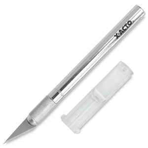

With an X-ACTO knife in hand, follow the placed outline to cut out the fingers, hand, and wrist carefully. To ensure the rectangular prisms resemble actual fingers, utilize the sanding sponge to smoothen the various edges and vertices. Next, on each finger, draw where the joints will be. Once marked, use a 45-degree cut to separate the three joints.

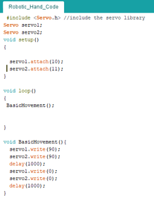

Step 4: Programming
Finally, the code must be written to enable movement throughout the fingers. Start by designating names for the motors such as servo1 & servo2, and providing them with pulse width modulation (PWM) pins like 10 and 11. After, create a void loop with your movement title being labelled underneath. Now with a void loop, the motors can go from 90 degrees, slightly pausing, then returning to 0 degrees; repeating this action indefinitely.
