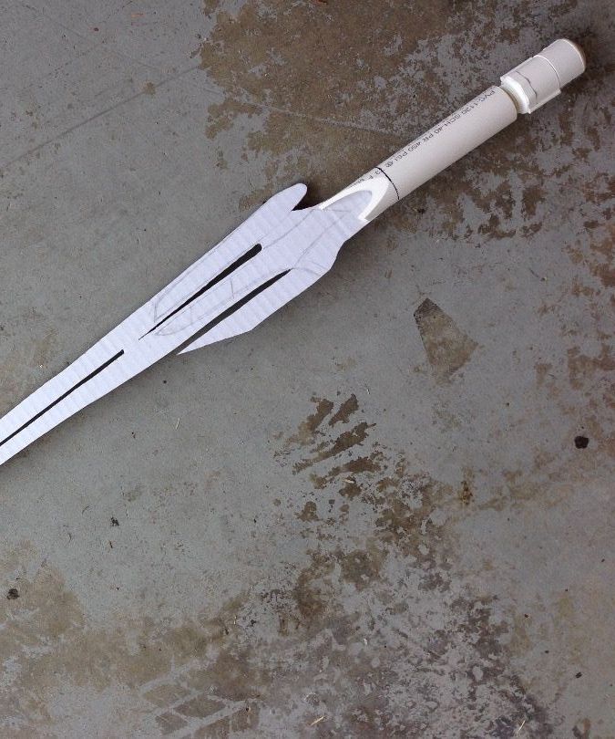

If you watched the movie, you know Rocket is some sort of super modified raccoon. As such, he is the size of a large raccoon. In comparison to his body size - his blaster is HUGE! So to translate that to a person dressed to be a small raccoon, I needed to make the blaster very large. I overall blaster is about 3 1/2' long, which is still not to scale, but worked well and was manageable for her to carry around.
I started by doing research on the internet and finding a picture of of the blaster that I liked. I printed it on transparency film. I taped some cardboard to the wall and projected the image on the cardboard and moved it back until it was the size I wanted. I traced the image on the cardboard, then folded the cardboard in half and taped the edges to hold them together. Any parts of the traced image that were going to be larger than the basic body of the blaster or on the side, I traced onto paper so I would have a template of the right size for each part. I used an Xacto knife to cut the shape out, and I had both halves since the cardboard was folded in half. After I had the two sides cut out, I estimated that I should make the blaster about 3" wide, so I cut a lot of long 3" wide strips of the cardboard. I began at the top of the blaster muzzle and began working on cutting relief lines into the 3" wide cardboard at each corner in the side pieces. I continued this process until I traced all around the blaster until I got to the bottom side of the muzzle. The muzzle was left open. For the curved parts, I repeated cut relief lines in the cardboard, at times only 1/4" apart, to allow it to copy the shape. I used craft glue and masking tape to bond the lower half of the 3" strips to both sides of the blaster. My initial idea was to use the expansion foam on the inside of the blaster in the middle of the cardboard to give it more strength and durability. I sprayed some expanding foam in, and then completed glueing and taping the remaining 3" strip along the top half of the blaster. Unfortunately, I was overzealous with the expanding foam and it began deforming and taking apart my seams, so I had to remove a side and scoop out some of the foam while it was still wet. I then glued and taped the sides back together. After the glue dried, the tape was removed.
I cut out and made many detail parts from the cardboard. The oversize muzzle, handle, extra grip and other detail pieces were all fabricated using the paper templates I drew earlier. Most of these pieces were attached to the blaster using small pieces of doubled up cardboard and glue in inconspicuous areas. The pistol grip, made of 3 pieces of cardboard glued together, was inserted into a hole I created on the underside of the blaster and taped and glued in place. The pistol grip was wrapped in tape to give it some texture. This was the only tape left in place on the final product.
I was unsure at first how to make the curved parts around the handle area of the blaster, but eventually came upon the small Home Depot trick or treat buckets that were made of a very thin plastic and were approximately the right circumference. I used extra craft foam to create a template for the curved piece that I copied onto the two sides of the bucket and cut with scissors. I added some cardboard areas to attached the curved pieces and glued them in place and temporarily held them with masking tape.
I used my PVC pipe and some fittings to create a scope for the blaster. One end is flared and curved, so I used a hand mitre saw to cut the top off a of small water bottle at a gentle angle. The PVC pipe and bottle top were glued together to achieve the results in the photos. The final detail was hot glueing two miniature plastic bottle lids to the top and one side of the scope for adjustment knobs.
