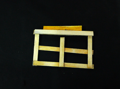

Create the Tool: Use coffee stirrers to form a small rectangular shape and stick it together with super glue.
Assemble: Attach this structure to the ice cream stick, then mount the ice cream stick onto the motor shaft.
