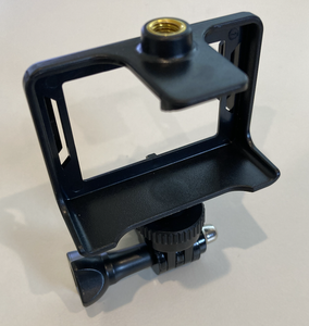

Step 2: Design Tripod Mount
Once you know what your building, we can start to design the tripod to hold the servo and camera.
I wanted my tripod to be very space-efficient, so I made it small and light and cut out weight anywhere I could. Also, I didn't want to deal with assembling it, so I needed to print it in one piece.
The end result of all of the above was this design, a circular disc with three square profiles lofted down and away. I filleted everything to either make it less sharp to touch or to add strength to the joints. I also carved out the inside of the legs using the shell function, significantly reducing the weight.
I put a hole in the middle of the disc to hold the servo. I didn't put enough of tolerance into the design and the servo was just a little too big, so you'll see a different, smaller servo throughout the design.
I printed it upside down (disc on the printer bed), and the entire thing printed in one piece.
Step 3: Mounting Servo and Camera
Hot glue doesn't adhere very well to shiny, smooth PLA filament, so you need to sand the top of the tripod a little bit to give the glue something to grip.
Once you do that, gluing the servo is easy, using the tabs on the servo to stick to the base.
If you know the orientation and position of your servo arm, you can glue the camera or camera mount onto the servo now. My servo wasn't centered, so I waited until I had created the code to center it and mount the camera.
