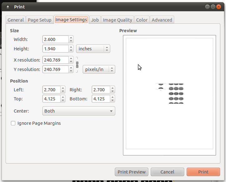

Thank you very much for this excellent Instructable! I've added it to my favorites, but I have one small gripe: I cannot open .docx files properly (Linux). I downloaded your JPG version of the layout, though, and after some experimentation got it printed correctly from GIMP. For anyone else struggling, I've attached a screenshot of my printing settings and the result (with a 555 IC as the star of the show).
1. Open image in GIMP (it can be found above)
2. Go to Image Settings and change Width to 2.60 inches. Height should auto-scale.
3. Print and fit! Cheers!
Reply 11 years ago on Introduction
Thanks for that info, that should work with any image printing software for anyone having trouble.
