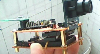

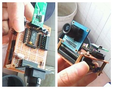

Step 1: Acquisition Module
This acquisition module is powered by the independent old lithium battery of the cell phone.

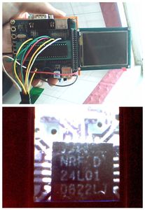

Step 2: TFT Receiver Display Module
It is the TFT receiver display module. This is also powered by the old lithium battery of the cell phone.

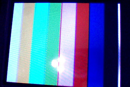

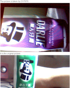

While the problem appears, why the picture taken by the OV7670 the green color will turn to the red and other color is basically no color ? Everything is normal when I debug.The output format is RGB565 and I try to change the register configurations which possibly have influence on.But the results are the same.
In my opinion, it should not be the problem of TFT display or disturb. And it may be the problem of the configuration of OV7670.But I don’t know which register configuration is wrong. I really hope someone could help me out about this problem.
At first I think it is the reason that I haven’t properly adjust the hue, that is to say it may be the hue register configuration of OV7670 is wrongly adjusted, but the key point is that there is no hue register configuration in OV7670. I am confused about it, it will be appreciated who can help me out.
