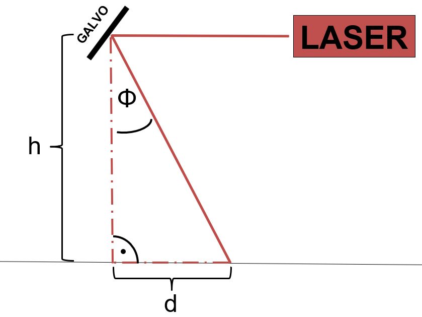

Now the controller needs to compute the signals to the right value for the DAC. Because the galvo will create a non linear polar coordinate system, a small calculation is needed to create a linear dependence between step and actual moved laser. Here I will show you a sketch of the calculation:
Now we need to find the formula for the calculation. Because I use a 12bit DAC, I can give out a voltage from -5 - +5V in 0 - 4096 steps. The galvo I have order has a total scan angle of 25° at -5 - +5V. So my angle phi is in a range from -12,5° - +12,5° . Finally I need to thought about the distance d . I personally want a scan field of 100x100mm, so my d will be 50mm. The high h will be the result of phi and d. h is 225,5mm. To bring the distance d in relation to the angle phi I used a little formula, which will use the tangents and convert the angle from radians into "DAC-values"
Finally I only need to add a bias of 2048, because my scanfield is center alignment and all of the calculations are done.

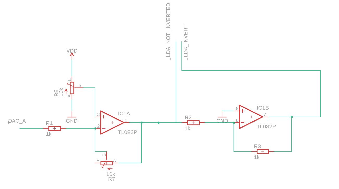

3. DAC
For the circuit I am using the same 12bit DAC "MCP4822" as deltaflo. Because the DAC is unipolar 0-4,2V and you need -+5V bipolar for the ILDA standard, you need to build a small circuit with some OpAmps. I am using TL082 OpAmps. You have to build this amplifier-circuit twice, because you need to controll two galvos. The two OpAmps are connected to -15 and +15V as their supply voltage.
4.GALVO
The last part is rather simple. The Output voltage of the two OPAmps will be connected to the ILDA Galvo drivers. And that's it, now you should be able to control the galvos with step and direction signals
Step 3: The Circuit
For the circuit I have used a prototype PCB.
You can connect the step and direction signals directly to the STM32, because I have activated internal pull down resistors. Also I have used 5V tolerant pins for the step, direction and center pins.
You can download the full schematic of the circuit below:

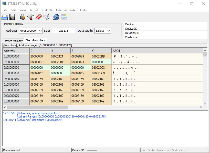

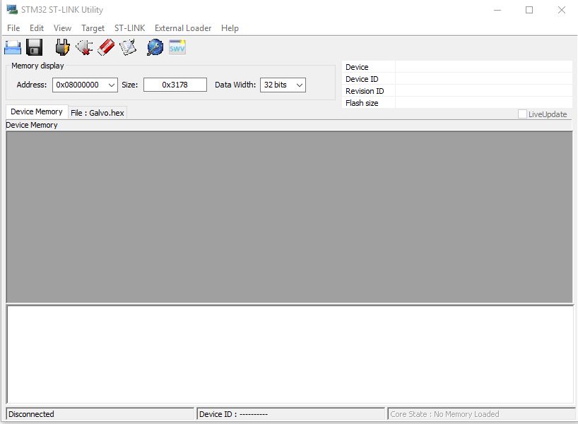

Step 4: Programming the STM32
The STM32 is programmed with Attolic TrueStudio and CubeMX . TrueStudio is free to use and you can download it here
Because TrueStudio is not that simple like for example the Arduino IDE, I have generated a .hex file, which you simply need to upload to the STM32 microcontroller.
In the following I will explain, how you uplaod the file to the STM32 "BluePill":
1. Download "STM32 ST-LINK Utility":
You can download the Software here
2.Install and open "STM32 ST-LINK Utility":
3. Now open the Galvo.hex file in the ST-Link Utility:
After that you need to connect the STM32 "BluePill" to the ST-Link-V2. Once connected click on the "Connect to traget Button":
Finally click on "Download". Now your STM32 should be flashed correctly.
In addition, I have attached all the source files for the Galvo_Controller in TrueStudio

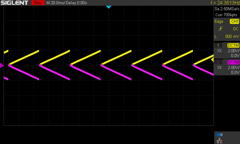

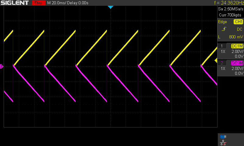

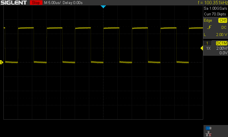

Now I will show you how you need to adjust the potentiometers on the circuit probably:
At first some background information about the ILDA standard. The ILDA standard is usually used for Laser shows, and consists of a 5V and a -5v signal. The both signals have the same amplitude, but with changed polarity. So what we have to to is to trim the output signal from the DAC to 5V and -5V.
Adjust the potentiometer:
What you can see here is the output voltage of this circuit at an input step frequency of 100kHz and with a constant direction signal. In this picture everything is fine. The amplitude goes from 0 to 5V and from 0 to -5 . Also the voltages are aligned probably.
Now I will show you what could get wrong while adjusting the potentiometer:
As you can see now both voltages are not aligned probably. The solution is to adjust the offset voltage from the OpAmp. You do that by adjusting the potentiometers "R8" and "R10".

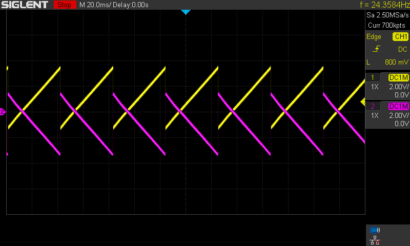

An other example:
As you can see now the voltages are aligned probably, but the amplitude is not 5V but 2V. The solution is to adjust the gain resistor from the OpAmp. You do that by adjusting the potentiometers "R7" and "R9".
