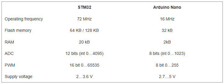

This time I will present you a classic 7 segment display alarm clock which will represent another one from my series of DIY unusual and ordinary clocks which you can watch on my playlist. In this case, it is characteristic that is used the STM32 microcontroller board known as "Blue Pill".
It is a popular and inexpensive development board based on the STM32F103C8T6 microcontroller from STMicroelectronics. The ARM Cortex-M3 core offers much more processing power and peripherals compared to typical 8-bit microcontrollers like those found in the Arduino.

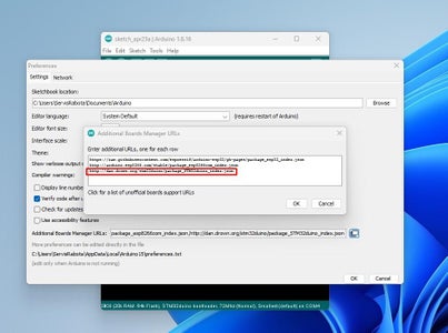

To start programming in the Arduino IDE, you need to add the STM32 board
- File > Settings > Additional links for board manager
Add line: http://dan.drown.org/stm32duino/package_STM32duino_index.json

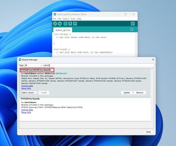

- Then, Open the board manager
Tools > Boards > Board Manager and type STM32 -> install

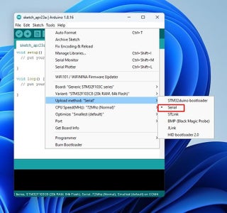

- Now we select "GenericSTM32 F103C series", and in the Upload method section, select Serial

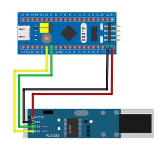

- The simplest way to upload the code is to use a small USB to COM adapter and connect it as shown in the diagram.
- First we need to set the jumper on the STM32 to "Program mode" as shown in the image.

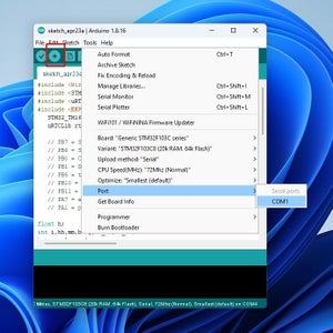

- Then, We select the COM port that corresponds to the USB to COM adapter and press upload.
When the upload is complete, we return the jumper to its original position, and remove the USB to COM adapter from the PC.
