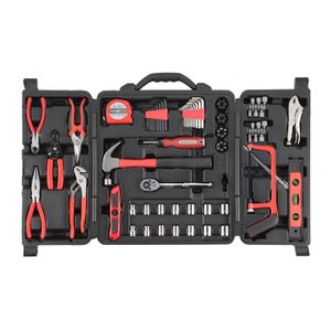

TOOLS REQUIRED:
  • drill machine with a small bit
  • screwdriver
  • metal file
  • hacksaw/something to cut the can
  • thumbpin
