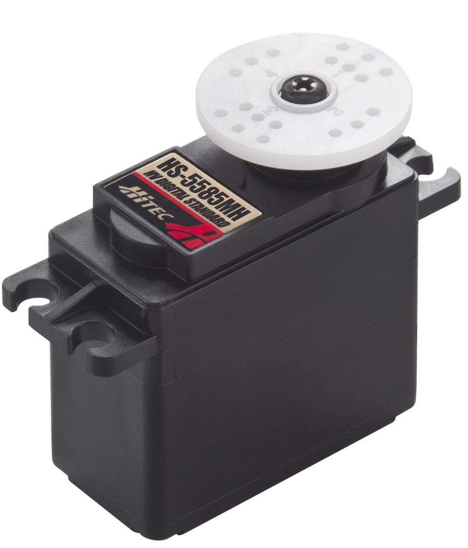

4. 3 x Servo motors

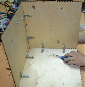

I made the box of the machine from plywood 3mm using BoxMaker this great software that you give it the dimensions and it will generate a PDF you can use to cut a notched box on a laser-cutter.
Unfortunately i found that this software has a bug at the last release that will make two parts from the box will not fit with the other parts, So please be careful.

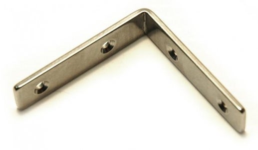

I used stainless steel angle brackets to fix the box sides.
I used 2 servo motors to lock the door and a small servo motor to push the door when you want to open it.

After cutting the plywood sheets using the laser cutter i found that there is a problem in fitting the parts of the box because of a bug in BoxMaker software so i used my driller to make some holes to fix the stainless steel angle brackets to fix the box sides.Then I used 3 small hinges to fix the door of the safe.
I used M4 Screws and nuts to fix the servo motors and Nylon Cable Tie Belts and double side glue tape to fix the servo motors to the safe door.

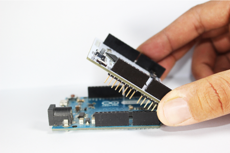

Finally, I fixed the Arduino and 1Sheeld using copper spacers.

Step 1: Place your 1Sheeld on your Arduino board then plug the Arduino to your laptop or PC.

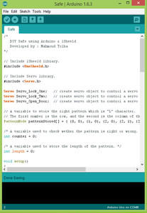

Step 5: Open my Arduino Sketch ( you will find it in the attached files)

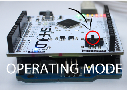

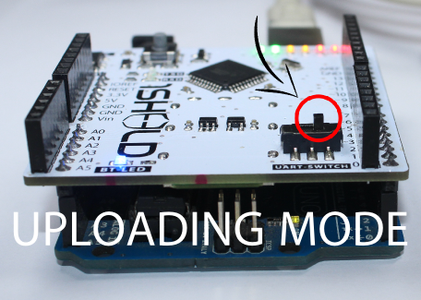

Step 6: Upload your sketch Hesre comes the most important part of the whole tutorial, switch 1Sheeld to the Uploading-mode (this is the switch labeled UART Switch on the board) before you upload your sketch to the Arduino board to avoid serial conflicts between 1Sheeld and Arduino, then press the Upload button in the IDE.
Upload mode is turned on when the UART switch is pushed away from the 1Sheeld logo.

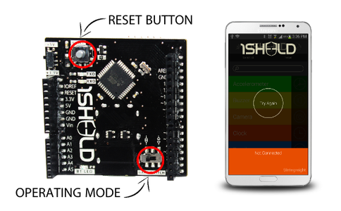

Once you have completed your upload you need to switch 1Sheeld back to the operating mode. Don’t forget! If you don’t switch the UART Switch back to the operating mode your project will not work properly as you will have no communication between 1Sheeld and the Arduino board.
Operating mode is turned on when the UART switch is pushed closest to the 1Sheeld logo.

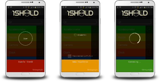

Step 7: Use 1Sheeld Application
Open 1Sheeld application on your Android smart phone. The application will first scan over bluetooth for your 1Sheeld, it will take a few seconds and the phone will find it. Once it appears on your screen as 1Sheeld #xxxx, you will be required to enter the pairing code (the default pairing code is 1234) and connect to 1Sheeld via bluetooth.
NOTE: If you are having trouble please make sure the bluetooth is turned on for your Android phone and that the Android phone is close to your 1Sheeld.

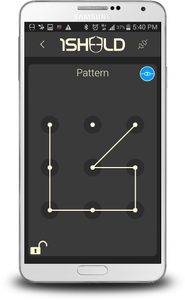

Step 8 : Access Pattern Shield
Select Pattern Shield from the shields list and press on the multiple shields icon at the top right of the app.
