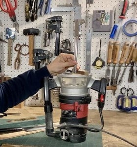

Pic 4 shows a small jig I made of scrap wood for setting the depth of cut on the router, pic 5. I made this by plunging the router into the small square piece and nailed a resting wood piece on it. The long piece rests on the plane of the base and the bit goes through the hole to set to 0.0875 inches.

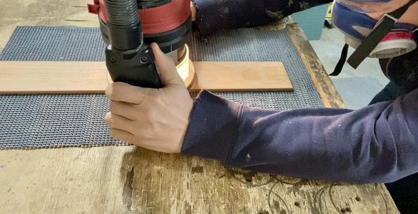

I used a V-groove bit to get as close as I could to the pencil mark (edge) I made where the blade will rest and then removed the inner excess with a 1/4 inch flush bit. In hindsight I felt comfortable enough to use the flush bit outright and that is what I did on side 2, but I was being overly cautious.
TIP: I used kitchen non skid material to keep my board from moving while the router was spinning.
I used a sacrificial piece of 1/4 inch thick wood to slide the router base all the way to the edge of where the blade will be inserted. This is a safety issue, too, since you wouldn't want the router to "fall away" when you get close to the edge. It also helps keep everything smooth and level. You don't want to make a topographical map in there, either.

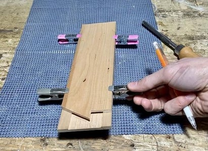

Now we are ready to glue the two pieces together. I had to use a lot more clamps than I anticipated since the wood had an annoyingly slight bow to it but everything worked out in the end. Plus I needed more pink mini clamps, pic 5!

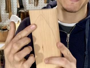

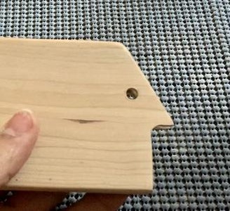

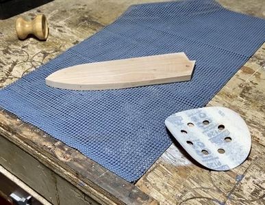

After the glue dried, I cut away the top part to make the sheath look more like a knife. I simply rested the blade on top and drew out about 3/4 of an inch, pic 1. I removed that with the bandsaw, pic 2 & 3, and then sanded the edges to make everything flush, pic 4.

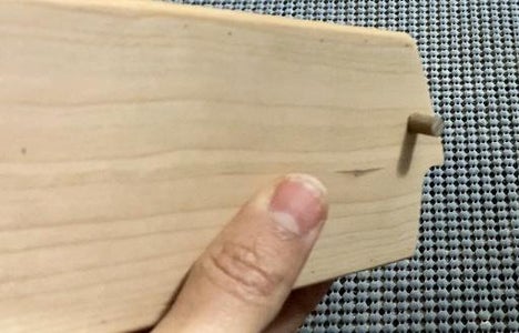

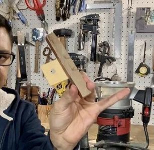

This next part is optional but I wanted to add a little more pizazz to there the pin would inevitably go. I decided to add some brass tubing to the guide and to do that I bought some inexpensive tubes that are supposed to be used for pen blanks, pic 5. I cut them to size, filed them smooth (you Don't want them to interfere with the insertion of the blade!), drilled a 1/4 inch hole, and epoxied them into place. This tube is 1/4 of an inch in circumference and so is my dowel. I realized that now it wouldn't fit in the hole and needed to trim it down ever so slightly. After yet another round of sanding, pic 6, I worked on the pin.
Step 5: Pin 'Em
My walnut 0.254 inch dowel needed to be trimmed to fit into a 0.240 hole. Yes, I measured with calipers and took it to the lathe. It may be overkill but I came this far and needed to ensure everything would come together like I envisioned. I even though of chucking it to my drill press to sand it.
After a couple passes and a light sanding, I got to 0.238 inches on my dowel and it slid in like a charm. I wanted it to be snug but not scrape the brass too harshly.

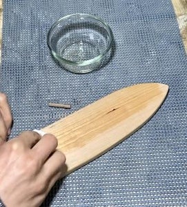

Now that everything is finished, it was time for...finish. For this I just used kitchen olive oil that way it was more food safe. I rubbed the outside but then noticed that I had to get the parts where the knife would be inserted. The contrast was driving my OCD crazy so I dipped an applicator in the oil and rubbed the inside, pic 3.
This turned out better than I imagined and I am hoping my buddy thinks so, too! It only took me a weekend to complete. The longest moments being the glue up, waiting for the epoxy to dry (overnight), and sanding. Lastly, this also beats having a knife block taking up valuable real estate on your kitchen counter, in my opinion.
