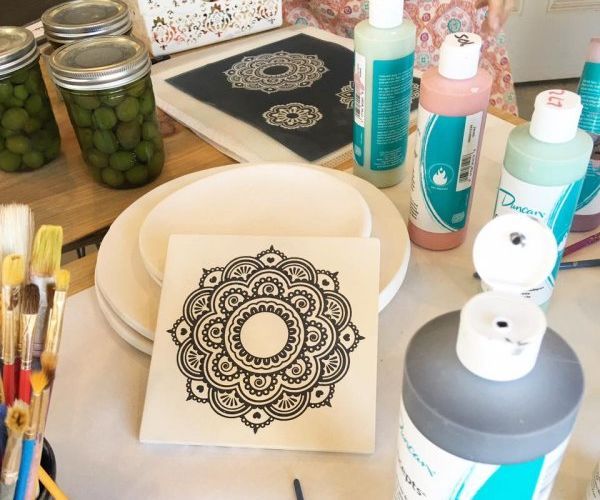

Step 11: Screen Print!!

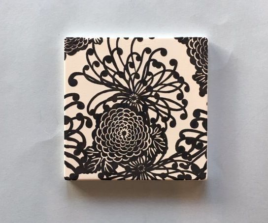

Now that the stencil is done, which takes less than 30 minutes, you can start using the stencil! I cut it half so each design is its own stencil, and starting screen printing the wood slices using speedball black ink and a brush.
Step 12: Screen Print All the Coasters
Using the same stencil, screen print as many coasters as you like :) I made 3 tree coasters and 3 bird coasters for a total of 6 custom screen printed wedding coasters. It was super simple, fun, and a huge hit with the couple!

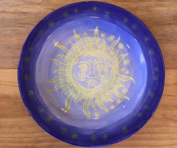

The EZScreen stencils can be used as many times as needed, on different types of surfaces.
I bought all the supplies (including speedball screen print ink) at www.ezscreenprint.com
After the black ink dried (about 1 hour for air dry) I sprayed a light layer of clear polyurethane over the coaster so it became water resistant.
