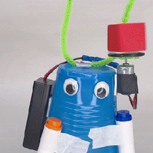

Next, attach the electronics to the cup with the adhesive squares. Press firmly for a stronger bond! The only requirement is that the motor shaft pokes out over an edge of the cup so there's room for the off-center weight to spin.
Step 3: Add an Off-center Weight
Fit the plastic wheel onto the motor hub. The center hole and some of the other holes fit snugly, some fit loosely. The loose fit is designed for other projects, but for the scribble bot make sure to use a snug-fitting hole.
Use an adhesive square to attach the foam cube onto the wheel. Make sure the cube is at least a little bit off-center so the robot vibrates when the wheel and cube spin.
Step 4: Tape on the Markers
Use at least two long pieces of tape per marker and make sure the felt tip will touch the paper when the caps are removed.
And of course give your robot some personality with wiggly eyes, pipe cleaners, a silly name and anything else!
