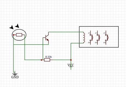

Step 2: Relay Photoresistor Switch
There is not a lot of components in this circuit.
Probably the easiest way to make this is to put all of the required components on board, bend the components leads, and then using the soldering iron and some solder connect them accordingly.

Step 4: Block Diagram and Principle of Operation:
When the laser beam gets interrupted relay closes its contacts completing the circuit between 230V AC and contactors electromagnetic coil. When that circuit closes 4 switches also close (L1-T1; L2-T2; L3-T3)+ Auxiliary contacts 13-14.
