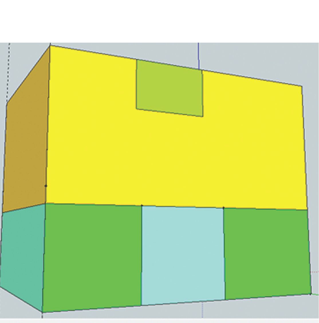

Step 2: Door Locking
Now,let’s see the detailed explanation
-------------------Door locking------------
It could be from home made to professionally made
digital door lock ( it basically locks which we can operate through micro-controller).
To make it homemade here are the things required
a) Metal frame (which could hold servo at the door latch).
b) Servo (9g can work but in case of stiff latch use a servo with greater efficiency.)
c) Arduino UNO
Now attach the servo to door latch using a stiff material (remember that material should freely move so that if servo moves down the latch gets unlocked and if the servo is turned upwards the door should get locked
Here are some images for it
