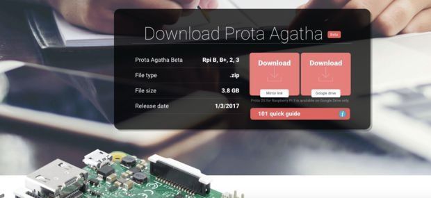

You first need to build the smart hub that will control the automation of your ring bell and connect all devices together. Prota OS for Raspberry Pi is our free smart hub OS which is very easy to install. In no time you will turn your Raspberry Pi into a smart home automation hub!
You can download Prota OS here. Then burn it on the SD card.
We made an easy guide you can follow to set up your Prota Pi.
Alternatively, you can check this Instructables.

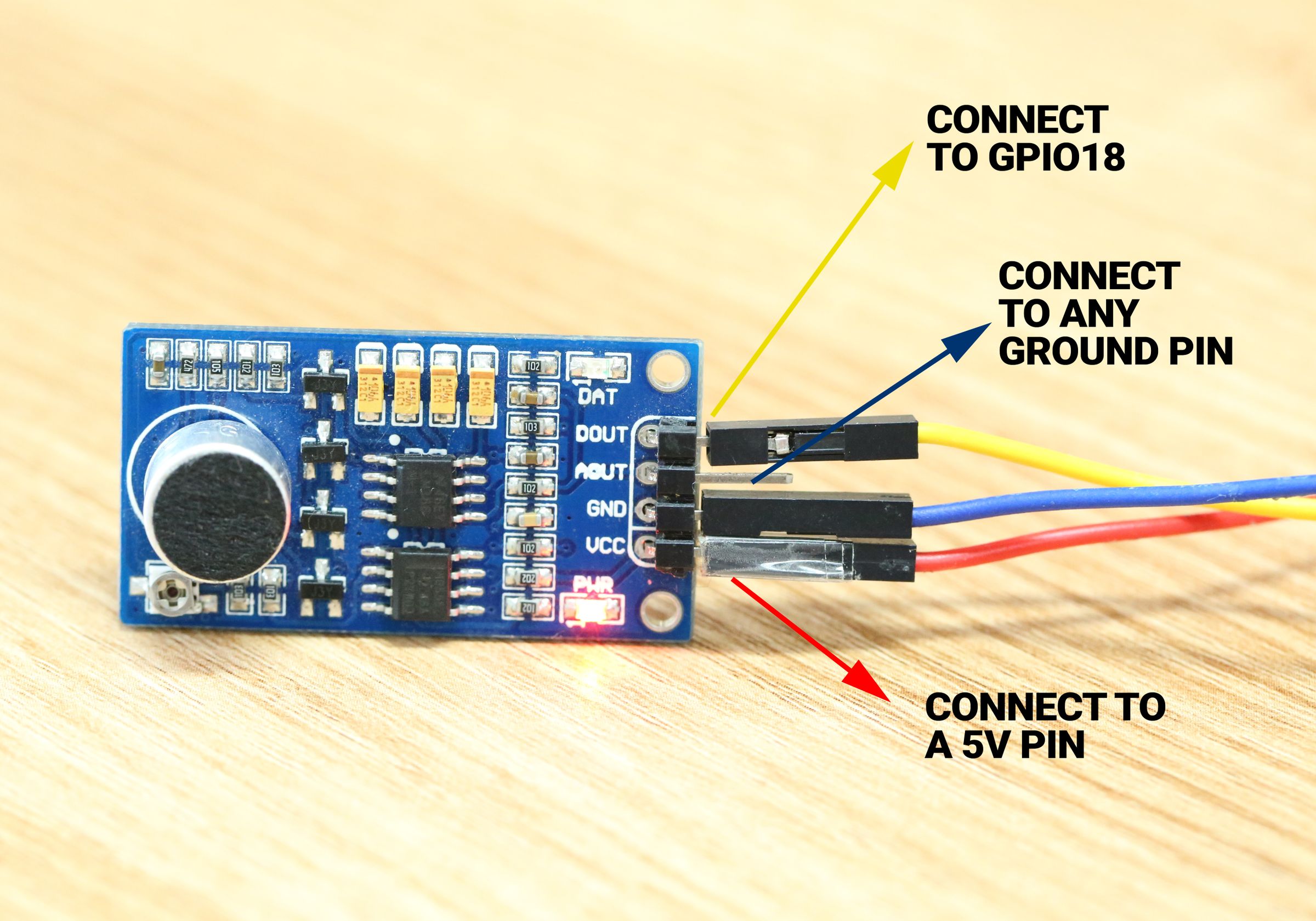

Step 3: INSTALL YOUR SOUND SENSOR
A sound sensor can be a great way to quickly detect any problem in your house. Both an intrusion or the smoke alarm turning on will be directly detected by the sound sensor which can then warn you and ask the webcam to take a picture to assess the situation.
Setting such sensor is very easy with your Prota Pi.

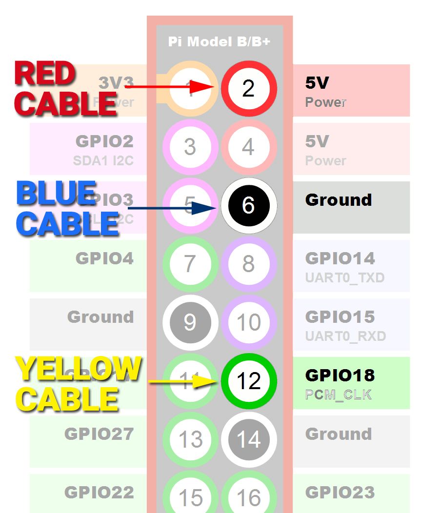

First connect your sensor to your Prota Pi with jumper wires as follow
  • Connect the GND pin of your sensor to PIN #3 of your Raspberry Pi
  • Connect the VCC pin of your sensor to PIN #1 of your Raspberry Pi
  • Connect the DOUT (digital output) pin of your sensor to PIN #12 (GPIO18) of your Raspberry PI

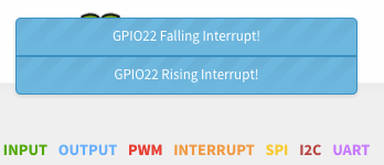

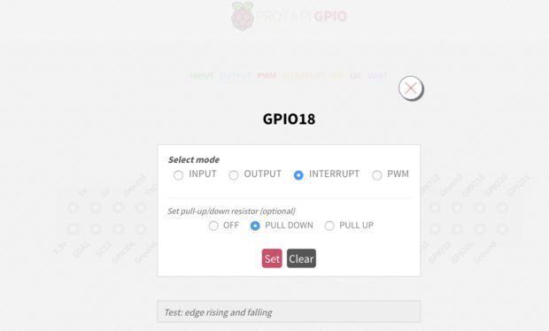

Now, via Prota Space:
  • Go to App Libraries and download GPIO app
  • Open GPIO app
  • Click on GPIO 18 and set it to Interrupt // Pull up
  • Click on “Set”
Now your Sensor will react to each close-by sound by displaying “Rising interrupt” and “Falling interrupt” on your GPIO interface (as below).

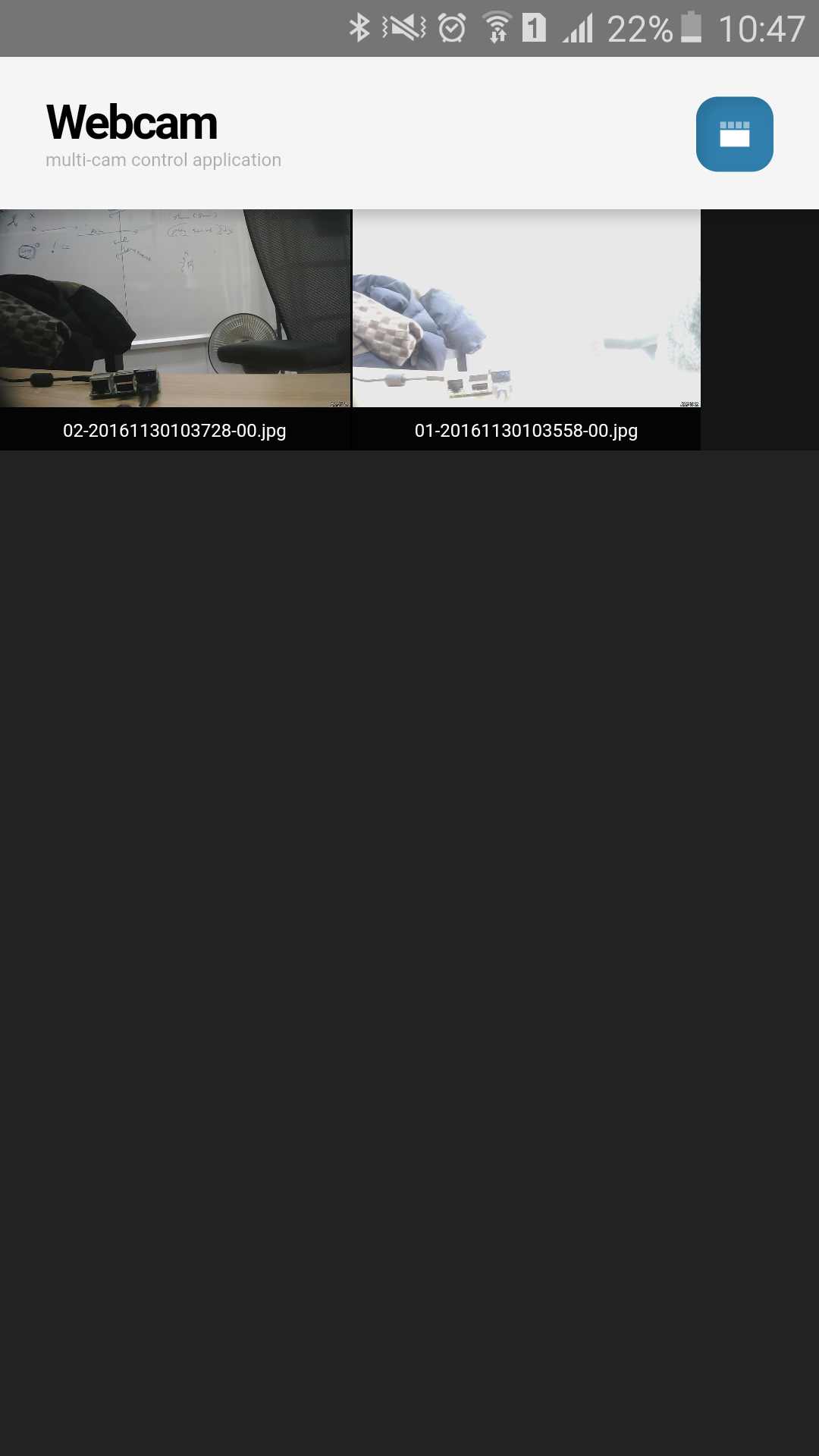

Now let’s quickly set up your old webcam to turn it into a smart cam!
  • Plug-in the camera’s USB cable to your Raspberry Pi
  • Download the Webcam app on your Prota Pi (in App Libraries)
  • Open the app to check that the camera is now working (it should start to automatically take screenshots in case of any motion)

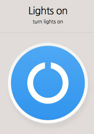

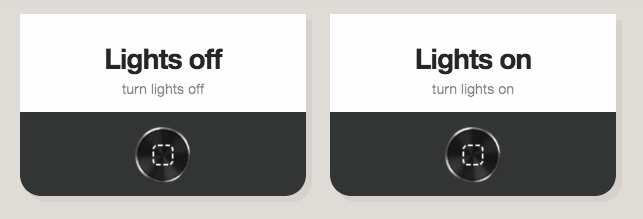

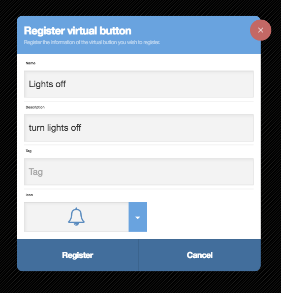

  • Go to App Libraries and download the Macro Buttons app
  • Click on + and name your button. Call it “Lights on” for instance.
  • Create a second button and call it “Lights off”

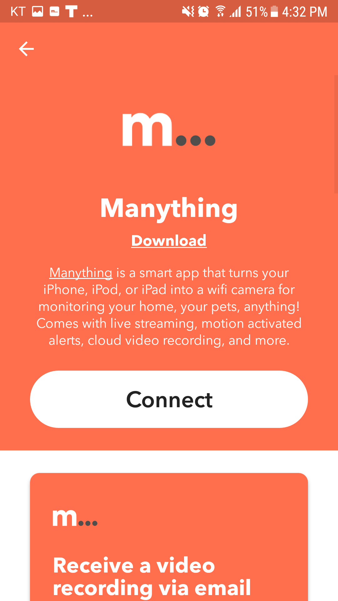

Step 6: TURN YOUR OLD SMARTPHONE INTO a SMART CAM
As we showcased in our DIY Smart Security project , you can turn an old smartphone into a smart cam by using ManyThing app, which is supported by IFTTT and therefore can be connected to your Prota hub.
  • Download the app on iOS or PlayStore depending on the smartphone you will use as a webcam.
  • Sign up and choose “Camera” to put it in Webcam mode (Viewer is the mode to use on the device from which you want to monitor).
  • Define the Settings according to your preferences
Install your smartphone either facing the entrance door (from outside or inside if you have a glass door or a side window) or in a sensitive room (for instance where you keep your valuables). Requirement: Your smartphone needs to be connected to a power supply to stay on during the whole length of your stay + it needs to be in reach of your WiFi connection.

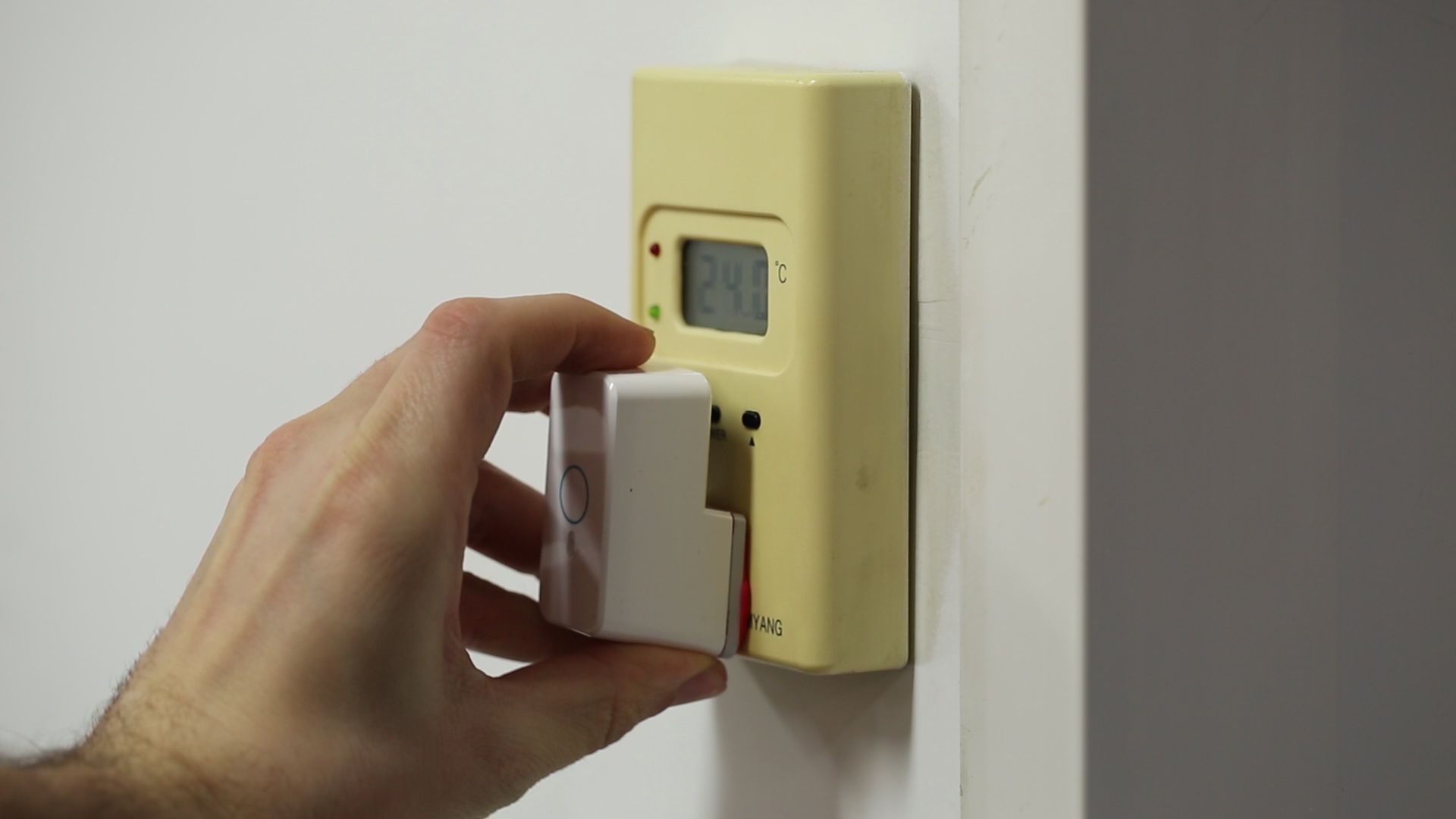

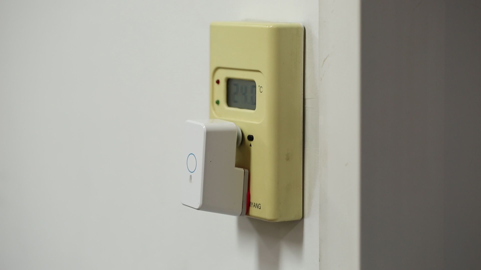

Step 7: MAKE YOUR HVAC APPLIANCE SMART
To allow you to come back into a warm house during the winter or a chilled one during summer without having a crazy energy bill due to HVAC appliances left on during, smart appliances can hopefully be triggered remotely. Most smart HVAC appliances are however very expensive.
MicroBot Push lets you turn any HVAC appliance that uses buttons to be turned on remotely based on your needs. It’s a much more affordable alternative and lets you keep your old appliance.
You can find MicroBot Push on Amazon (US/UK/CA) or on our website.
Here is how you can set it on your heater (it also works well on an AC appliance):
  • Turn on the MicroBot Push
  • Go to your Prota Pi homescreen and click on “Pair now” button next to MicroBots
  • When the LED statuses are sync, press on the physical button of your MicroBot Push to pair with your Prota Pi
  • Install on your HVAC appliance and it’s ready to use!

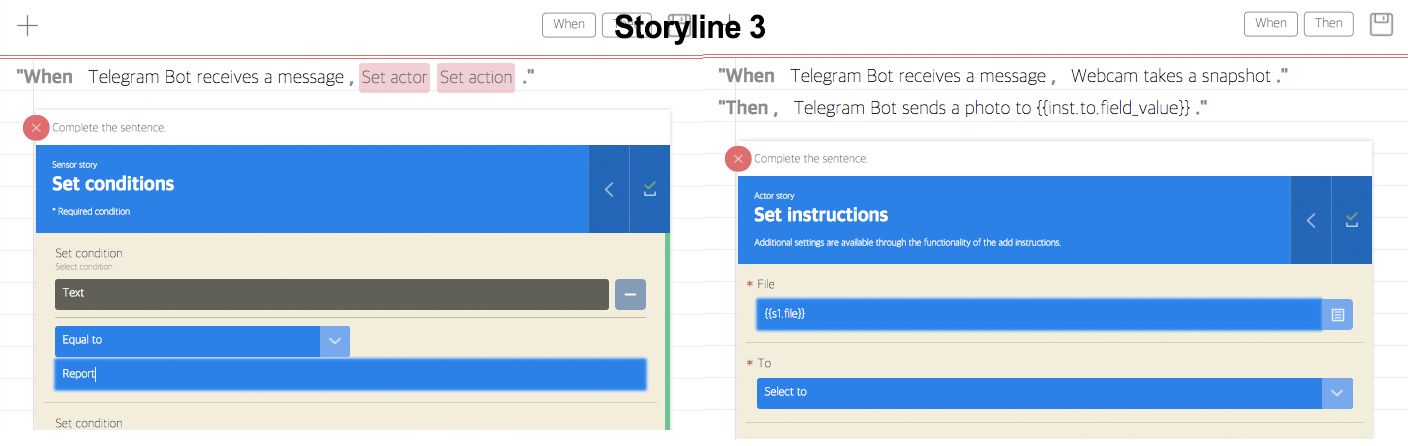

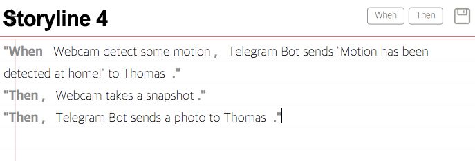

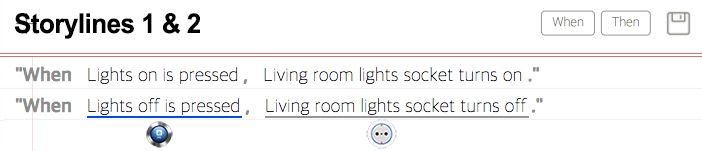

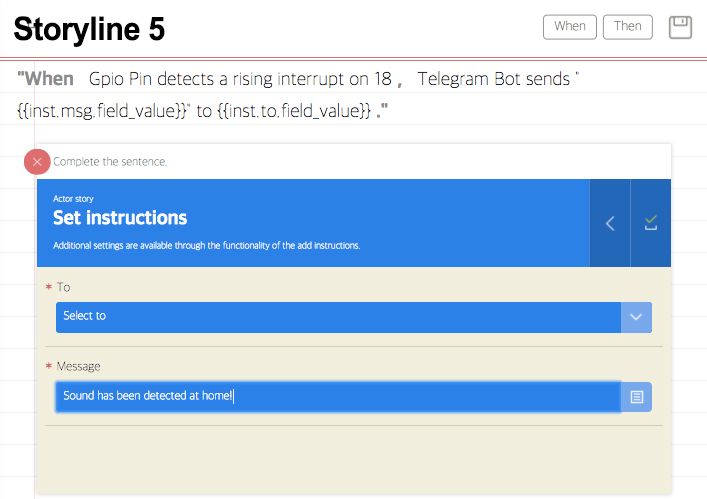

Write the automation storylines on Stories app
Stories is the automation tool that allows you to write automation workflows very simply, in natural language.
  1. When Macro Button Lights On is pressed, On/Off switch turn on
  2. When Macro Button Lights Off is pressed, On/Off switch turn off
  3. When TelegramBot receives “Report”, Webcam takes a snapshot then Telegram Bot sends image file.
  4. When Webcam detects some motion, Telegram Bot writes “Motion has been detected at home!” Then Webcam takes a snapshot Then Telegram Bot sends image file.
  5. When GPIO18 detects a rising interrupt, Telegram Bot writes “Sound has been detected at home!” Then Webcam takes a snapshot Then Telegram Bot sends image file.

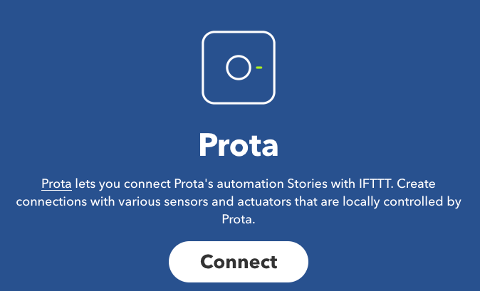

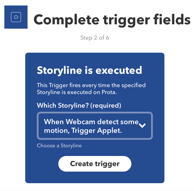

Connect to IFTTT
  • Download the IFTTT app from your Prota’s App Libraries (this app has no interface, it allows connection between your Prota and IFTTT)
  • Go to IFTTT.com or on the IFTTT app, create an IFTTT account and search for the “Prota” channel. Click on connect and select your Prota (you need to have granted access to your Prota Space to the device you’re using)
  • Search for the “Manything” channel and connect your Manything account to it
  • Search for the “Telegram” channel and connect your Telegram account to it

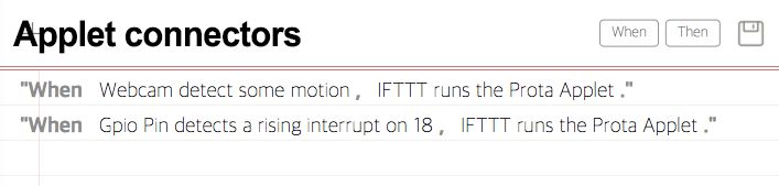

Write connecting storylines in Stories app
You can easily connect your storylines with IFTTT. For that you need to write the storylines before-hand. Write the following:
  1. When GPIO18 detects a rising interrupt, IFTTT applet runs.
  2. When Webcam detects some motion, IFTTT applet runs.

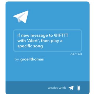

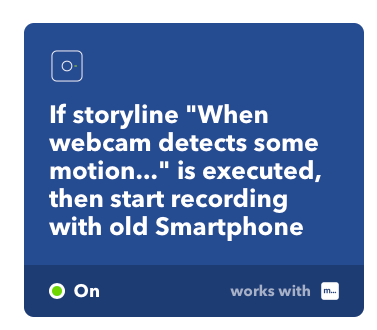

Create the following applets on IFTTT
  1. IF Prota execute the storyline “When webcam detects motion…”, THEN Manything start recording
  2. IF Prota execute the storyline “When GPIO18 detects a rising interrupt...” (= sound detected), THEN Manything start recording
  3. IF Telegram receives a message “Alert”, THEN Android Device plays a song
For the last one, it’s necessary that you name a specific song name as registered on your phone. We use this applet to trigger an alarm sound that will either warn the neighbors or scare off the intruders (or both). You can download free sounds on http://soundbible.com/ .
