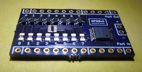

The other board that I used is known as the NPN8. It allows you to use a shift register to control 8 NPN transistors which allows you to drive items with larger currents if your microcontroller can't source the power needed to whatever 8 items you want to drive (example: motors, solenoids, etc).
In the second picture, the bottom right pins are where the Power, Ground, Clock, Latch, and Serial Data from the Propeller Demo Board are connected to. So that's what I did first as seen in the third picture. It's a little blurry but I put the Power wire on the 3.3V of the Propeller Demo Board, Ground on VSS, Clock, Latch, and Serial Data went on pins 2, 1, and 0 respectively.

Next I needed to add the LEDs. Essentially on the NPN8 board, the top row of pins headers (0-7) connect to the emitters of the NPN transistors on the board. The bottom row of pin headers (0-7) connect to the collectors of the NPN transistors. In NPN transistors, emitters are usually connected to ground and collectors are usually connected to power.
Here, we are using the LEDs as a middle man - when we tell the Propeller to tell the shift register we want an LED lit up, power goes THROUGH the LED, then through the collector side of the board and out the emitter side of the board.
So to prepare the LEDs, I first used ribbon cable, stripped and tinned the ends with solder, and then soldered a wire to each cathode of the LED. I soldered those wires to the collector side of the board (Port In). (PIC 1, 2 and 3)

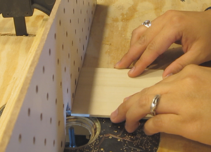

Of course, with all of these wires, it just didn't look that good. So I looked around for some scrap pieces of wood. Fortunately, from another project, I had random hobby wood of different sizes. Using our hackerspace's routing table, I routed rabbet joints into the pieces of wood much like the link shows. (PIC 1)
The bottom piece of the box had rabbet joints routed into the left and right side (which ever sides are longer). Two pieces of wood were trimmed to the same length as the bottom piece of the box for the sides (no rabbet joints). And the two remaining sides were routed with rabbet joints on 3 sides (left/bottom/right). When you fit the 5 sides together, they make for a elegant but simple box.
So we glued it up with wood glue and let it sit for an hour.

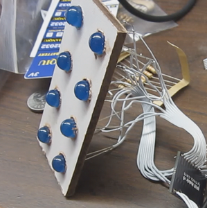

I wanted the LEDs to be equidistant from each other and noticed we had leftover pegboard. So after cutting it down to size (2x4 for 8 LEDs), and enlarging the holes for the LEDs themselves, we had a very nice method of keeping them in line. (PIC 2)

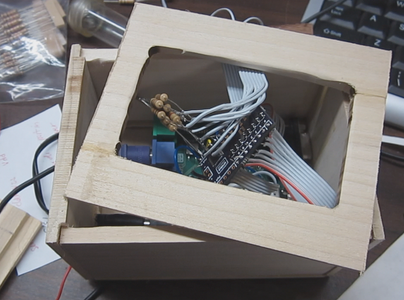

I hotglued them into place. And then because it was about 3AM at the time, I placed the demo board, and the wires into the lantern chassis (PIC 3 and 4). I also hot glued cardboard shims to the top and bottom of the pegboard-LED-holder so that the pegboard would fit snugly into the now-completed wooden lantern chassis. (PIC 5)

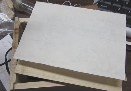

A cover was made and a hole was routed out (not without some difficulty mind you). And then I cut a piece of rice paper to fit and glued it on to the BACK of the cover.
