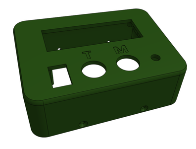

Step 1: Printing All the Parts!
I used my Original Prusa MK4 with ESun PLA+ for this example.
Here is my preference in Printing Settings:
  • Nozzle: 0.4mm
  • Layer Height: 0.2mm
  • Infill: 60%
  • Perimeters: 3
  • No brim or Raft
  • Use Supports (Case.stl, Lid.stl, Knob.stl)
  • Don't Use Supports (Separator.stl, Seamer.stl)

Buttons
Then Slide the standard 16mm push buttons through the 2 middle holes of the Case.stl from top. Then fasten Them in place using the nuts that come in the package.
Tip: Use a pair of pliers to tighten the nuts!

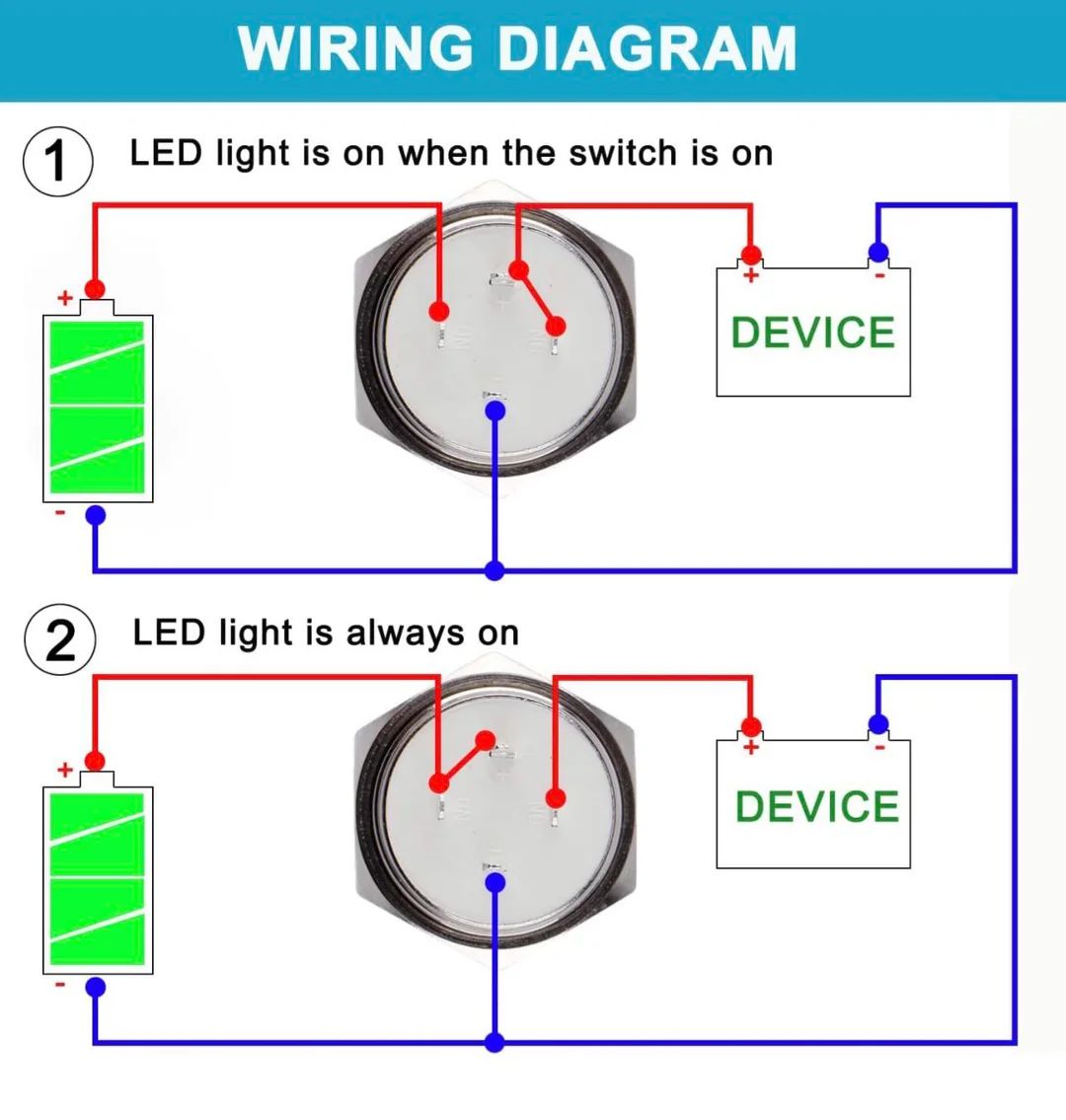

Step 12: Push Button GND
Now we connect the GND to the push button. Use 12cm cable (around 26-28AWG) to connect it to one of the terminals of the pushbutton.
The push buttons are configured as INPUT_PULLUP. Chech more for INPUT_PULLUP here!
nfo: If you have illuminated push-buttons instead of just connecting one of the terminals with a GND wire, you should bridge the LED (-) and one of the terminals with the GND wire, just like in my example!
I prefer the LED of the button to be always on (this tutorial follows that concept). But feel free to use any of the 2 scenarios in the schematic in the last picture/attachment! (credits to reddit's "r/electrical" for the post)

Step 16: Pushbutton LED Positive Connection
Use a piece of wire around 10cm to connect the (+) terminals of the LEDs in the buttons.
(This step is for those who have illuminated buttons)

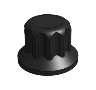

Step 26: Add the Knob.stl
Take the Knob.stl and press fit it on the Potentiometer.
And that's it for the hardware!
