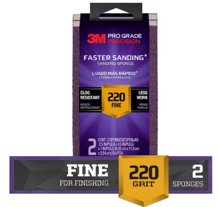

Step 7: Sand Your Pieces
After I finished cutting my pieces, I noticed they were not very smooth. Although it's just my shoes on the rack, I'm going for a clean, modern look. I decided to sand the entire board and the posts. I used the medium-grain and fine-grain sandpaper shown above. After sanding, I felt the boards and posts to ensure they were smooth to the touch, so I wouldn't get any splinters when putting my shoes away. This was my indicator I could start applying the stainer.
