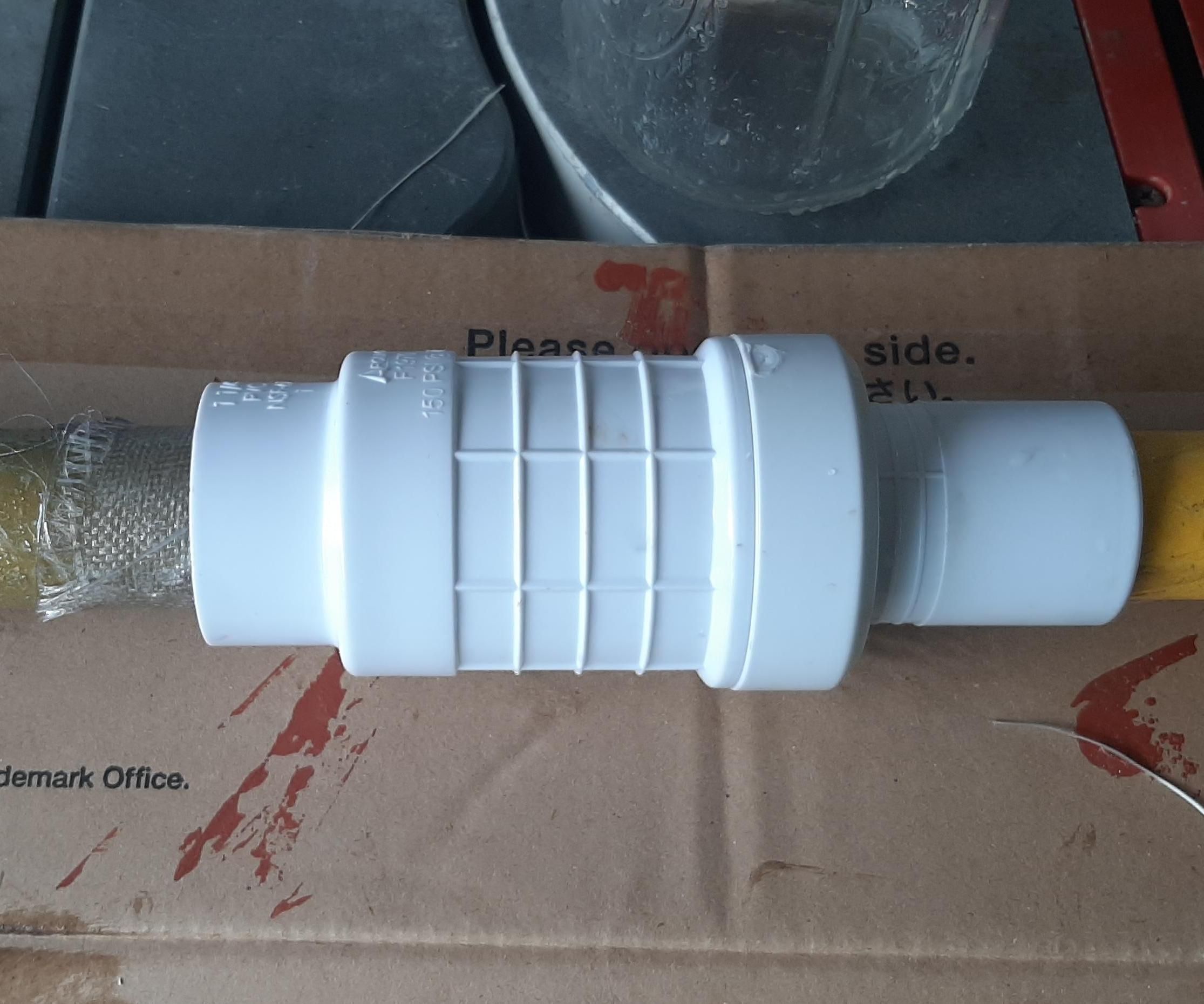

Step 4: Cut Your Pvc, Do a Dry Fitting
Cut your 2 inch PVC pipe so that you have two longer lengths (I went about 10 inches) and one shorter length (of about 4 inches). If you don't own a pipe cutter, a hack saw works well. If you don't have a hack saw, use whatever saw has the smallest teeth (highest TPI count) that you can find. Don't sweat it if your cuts aren't perfectly square: the cut ends will be hidden inside the fittings, so it's very forgiving to a sloppy cut. Use a file or sandpaper to clean the burs from the cuts, and sand both the pipe and the fittings with medium-fine grit sandpaper where they will mate. Clean off the PVC dust, and do a dry fitting.
Here is where you can cut out a couple 2" circles of shade cloth, etc. to use as screens to partition the sections in order to keep the zeolite in one chamber and the carbon in the other. PVC cement them into place, taking care to trim/cut any that overlaps the outer diameter of the pipe (which would interfere with the fitting).
Step 5: Glue It Up
If everything looks like it should, you can disassemble, apply the PVC cement to both mating surfaces, (after roughing them up a bit with sandpaper) and put them together (make sure you have a roll of paper towels and some acetone close at hand for clean up) . A rubber mallet is helpful for getting a tight fit.
Drill a hole in the bottom of the middle length of pipe, just smaller than the diameter of the threads on your needle valve. This is important: any water that collects in here in between showers will have been dechlorinated by the activated carbon. That means that it is now susceptible to legionella, the cause of Legionnaires Disease. Now, this does not spring up overnight, but, say you go out of town for a couple weeks and leave that dechlorinated water within your filter/softener ... yep, best to open the valve and let it drain if it isn't going to be used for more than a day or two.
Step 6: Insert Bulkhead Fittings
Now, measure your bulkhead fittings to see what size hole saw you'll need. If you don't have it, buy that sized hole saw (and a chuck if you don't have one) and use it to drill into the top of the pipe caps. Sandwich the cap between the two mating pieces of the 1/2" bulkhead fitting (after wrapping the threads with Teflon tape to prevent leakage). You now have your filter/softener assembled.
Step 7: Install Shower Head to Stem
Go ahead and install your shower head (again making use of Teflon tape), with one deviation from the stock instructions: instead of running the hose directly to the shower head from the stem, run one hose from the stem to your softener, with the second hose returning from the filter/softener to the shower head. Voila! You've just saved about 500 dollars (on the low end). The one downside is that, instead of having a system that automatically recharges your zeolite, you must change it out and recharge it manually. If it should happen that you, like me, are not made of money, this softener may be the next best thing. Bon douche!
