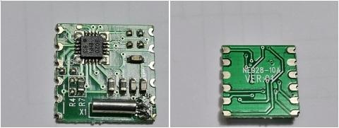

In short, the Si4732 and Si 4735 chip support FM, AM, and SSB (USB & LSB) modulation and RDS on FM. Unfortunately in this case I use SI4730-B20 based Radio module labeled “NE928-10A V:01” which DOES NOT SUPPORT LW, SW, and FM/RDS. As soon as I receive the Si4732 chip from AliExpress, I will replace the current board with this chip and without any changes in the software, the complete features will be obtained. I hope to present that soon.

- SI4730 radio module
