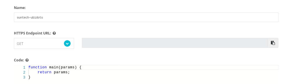

Step 5: Ubidots Parser Set Up
Note: a parser is a Node.js cloud function executed when a GET, POST, or HTTPS request is made in the Parser URL as illustrated above.
1. For creating a Parser go to your Ubidots account -> Device Management -> Parsers.
NOTE: If you cannot see the Parsers module in your account, you will need to enable the add-on for $30/month in the billing section of your account.
2. Click the blue plus icon in the upper-right corner to create parsers.
3. Assign a name to the Parser, e.g. "suntech-ubidots", to identify it in the Sigfox backend later.
4. Assign the POST as the HTTP method from the scrollbar.
5. Click on "Make it live" to generate an API endpoint URL containing the name of your parser. The URL should look like shown above
6. Now, just copy and paste the code located below into the Ubiparsers Editor. When pasted, assign your Ubidots TOKEN where indicated:
var request = require('request-promise');
var token = "xxxxxxxxxxxxx"; // Assign your Ubidots TOKEN async function main(params) { var device_id = params.device_id; var buf = new Buffer(params.data, 'hex') console.log(buf); var msg_type = buf.readInt8(0); if(msg_type == 2){ var lat = buf.readFloatBE(1); var lng = buf.readFloatBE(5); console.log(lat); console.log(lng); } // Build payload var payload = {"position": {"value":"1", "context":{"lat": lat, "lng":lng}}}; // Make POST request to Ubidots var post_response = await ubidotsPost(token, device_id, payload); // Pass Ubidots' API response to the parser' response return post_response; } async function ubidotsPost(token, device_label, data) { var options = { method: 'POST', url: 'https://industrial.api.ubidots.com/api/v1.6/devices/' + device_label + '?force=true', body: data, json: true, headers: { 'Content-Type': 'application/json', 'X-Auth-Token': token } }; return request.post(options); }For running a Parser test, please paste this code in the editor that popups:
{"device_id": "12345", "data": "02c1b6c81cc23c5514"}

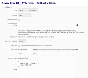

Step 6: Sigfox Callback Configuration
Click here for an intro and docs to configure a call in the Sigfox backend with your Suntech device. For this, you will need to use the parameters listed below.
Type: DATA - UPLINK
Channel: URL Custom payload config: Leave it in blank
Url pattern: https://parse.ubidots.com/prv/iotexpo/suntech-ubi... (this is the URL generated by the Ubidots parser in the step above)
Use HTTP method: POST
Header: X-Auth-Token - {Assign_your_ubidots_token}Content Type: application/json
Body:
"device_id": "{device}", "data":"{data}" }
When the callback is executed properly, your Sigfox backend will look similar to the image above.

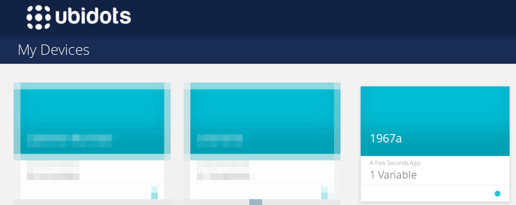

2. Press "OK" to save all the changes and visualize your new device in Ubidots.
With this, your Sigfox callback is ready and the Ubiparser is properly transforming data received to Ubidots cloud. Now it is time to develop your application with Ubidots code-free IoT application tools.
Go to the Device section and see a newly created device with the ID of Suntech Device as name.
