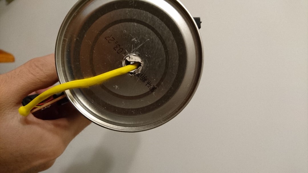

2. Drilling a small hole at the bottom of empty can and fix the bulbs with Power Putty
3. Let the wires through the hole, I recommend that heat shrink tubing the wires after wiring to protect the wires and make it tidy.

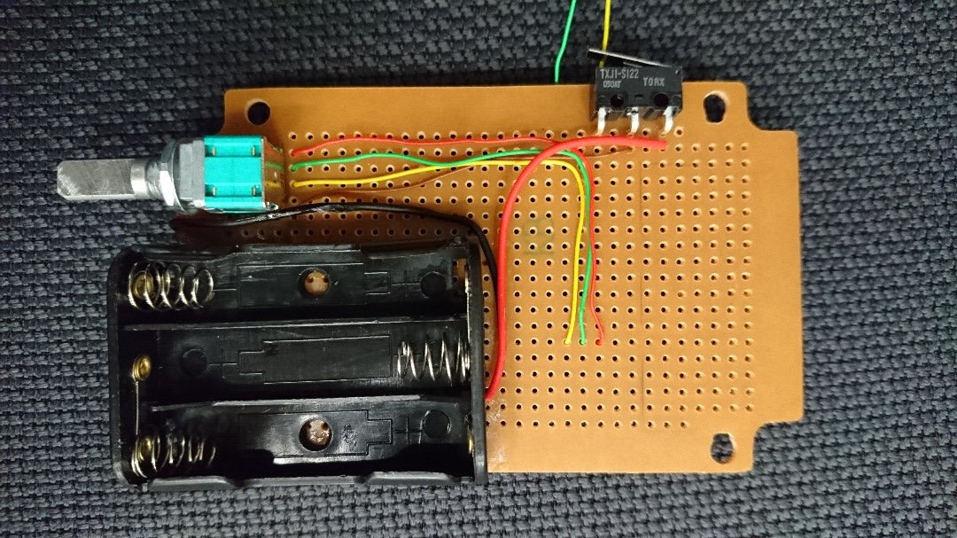

1. According the circuit diagram, soldering and wiring the micro switch, rotary selector switch & battery holder on the strip board.
2. The strip board is the grip of your gun, and micro switch is the trigger.

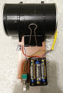

1. Clamp the circuit board by binder clip and fix these with Power Putty, the binder clip will become a “Barrel Holder”.
2. Mount and tie the Barrel on the barrel holder
3. Connecting the wires between circuit board & bulbs
