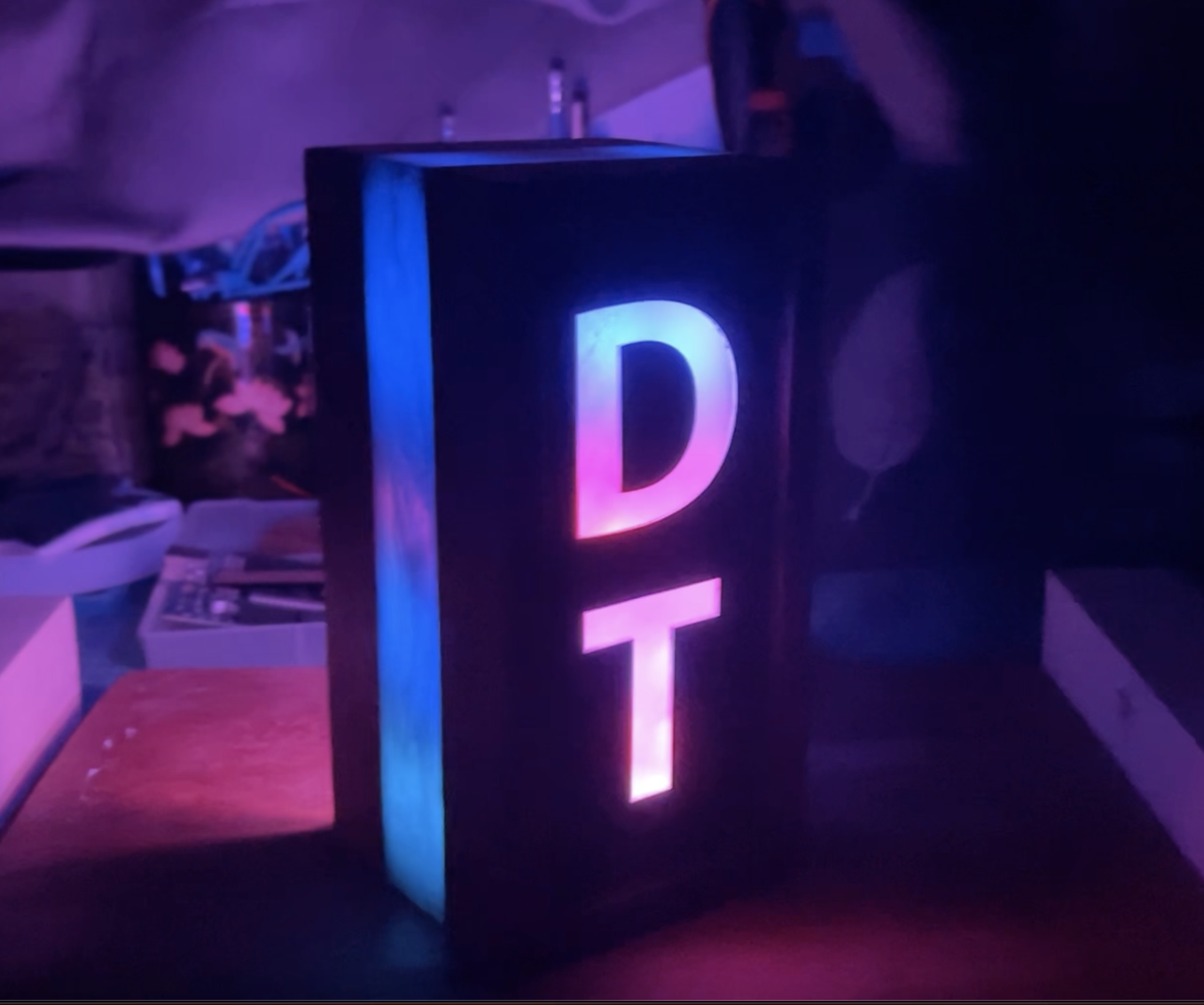

The first step is going to be running the LED Strip out of the bottom of your toilet rolls and then wrapping it around the outside from bottom to top. Most LED Strips come with a sticky side one you peel off the plastic. For this step, I recommend evenly spacing the LED Strip. As seen in my picture mine wasn't perfect but there wasn't much of a difference at the end.
At this point, you should have the USB cable and the Led Strip running out of the bottom of the tube with the button wires coming out the top. I don't recommend putting the USB through its hole yet because the next step is wrapping the outside of the tennis ball can in the baking sheet (any sheet that allows the light to pass through will work). If the button isn't staying down in it's intended to position you can super-glue it. One final note is to make sure none of the wires are outside the toilet paper rolls because then they will create shadows with the LEDs.
Before we do this you may have noticed I put a little message on my lamp. This was done by cutting out the characters from a malleable thin piece of cardboard that didn't allow the light to pass through. I then super glued these characters to the outside of the can before wrapping it.
Now, the next step is extremely important because any folds/creases in the baking sheet at the end will show with the light. I recommend using any plastic friendly adhesive (make sure it's not quick drying).
Now once the glue has dried you're going to want to cut a small hole with a sharp knife or something similar for the USB hole. The last step is to run the USB cable out of the can and push the toilet paper roll up inside. Then seal off the bottle with the cap.
One final optional step is wrapping the entire thing in a plastic wrap to make sure the baking sheet doesn't get damaged. Above I have attached a short video of my lamp at the end. Please leave a comment if you have any questions or problems regarding this project.
