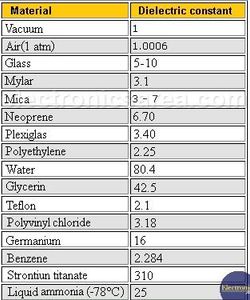

  Now let's not go into the explanation of the term dielectric constant, just to give you an example of its value for some materials. For Water, dielectric constant is 80, glass from 4 to 12, PVC 4, for wood about 3, the human body about 40, and dry air has exactly 1 dielectric constant.
 It can be seen from the above that the sensor will be most sensitive to water, than human body, etc...
