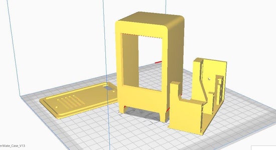

Step 2: 3D Printed Enclosure
First print the project enclosure
I have used my Ender3 3D printer and 1.75 mm skyblue and RED PLA filaments to print the parts.
It took me about 6 hours to print parts.
The enclosure has 3 parts:
1. case
2. Back Cover
3. Mount
My settings are:
  • Print Speed: 60 mm/s
  • Layer height: 0.2mm ( 0.3 also works well)
  • Fill Density: 20%
  • Extruder Temperature: 220degC
  • Bed Temp: 60deg C

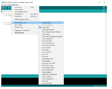

    Step 7: Preparation of Arduino IDE for ESP8266
    The ESP8266 module isn't part of the Arduino-IDE.
    1. We have to install it first. Open file / preferences in the Aduino -IDE and insert the following link in the Additional Boards Manager URLs field: http://arduino.esp8266.com/stable/package_esp8266...
    2. this window with the OK Button.
    3. Open now the board manager: Tools / Board / Board Manager
    4. Go to the ESP8266 board entry and install it now you can choose LOLIN(WEMOS) D1 R2 & mini.
    5. Set the CPU frequency to 80MHz, Flash Size to "4MB (FS:3MB OTA:~512KB)", and the COM port.

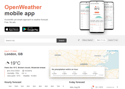

    Step 9: Create Open WeatherMap API Key
    As your device will be displaying data from OpenWeatherMap you need an "API key" from them.
    1. Go to https://openweathermap.org/price
    2. note of the features in the "Free" column.
    3. By using the free plan you are limited to 60 calls per minute.
    4. In the "Free" column click on "Get API key and Start".
    5. Once the API key is created you can come back to this page any time to edit or delete it.
    API key which will be required in our code in the next step.
