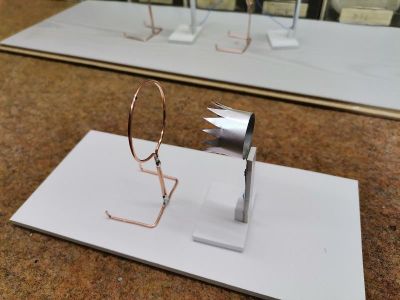

  I tried to construct as simple as possible such a device that does not require precise 3D printed parts, so that it can be made by less experienced makers. From the material we need an ordinary 2.5mm copper wire used in house installations, a small metal plate (in this case aluminum), and a high voltage source.

  For the high voltage source I am currently using a "Plazma Speaker board" that I bought earlier for testing purposes, and for this project it turned out to be great because the output voltage can be changed simply with this trimmer potentiometer. Otherwise, any source of high voltage greater than 15-20kV can be used. You can build your own HV source described in one of my earlier videos.

  One electrode is static and glued to the base, while the other can be moved to achieve the ideal distance. To increase the thrust I will use three stages, actually three identical units placed in the same line.
The electrodes are connected by a parallel connection. Serial way of placing the motors is suitable in the case where a greater absolute thrust is needed on a small surface (for example when turning in a certain direction), while for constant movement in one direction, the stages should be placed in the same plane, one near one. As the power increases, the thrust increases proportionally. If we reduce or completely turn off the lighting, an incredibly beautiful visual effect is obtained. A trapezoid formed by plasma can be seen between the electrodes.
