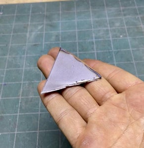

For my key, I gathered a piece of 1/8-inch metal cutoff (pic 1) from my industrial lamp build, a large nail (pic 2), and some sheet metal (pic 8).

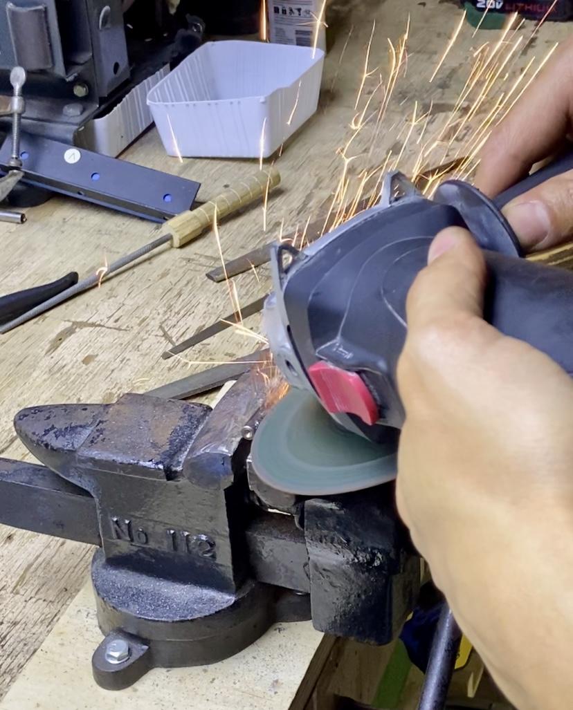

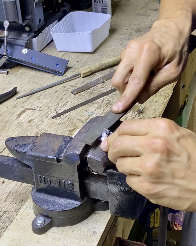

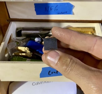

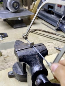

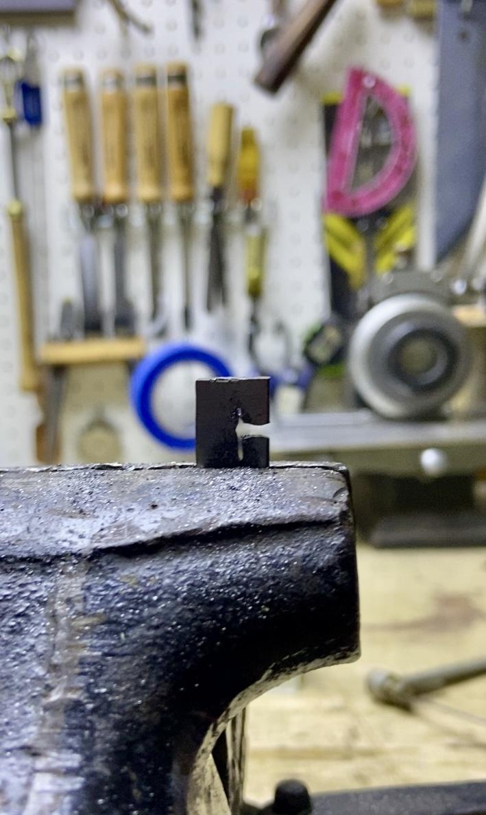

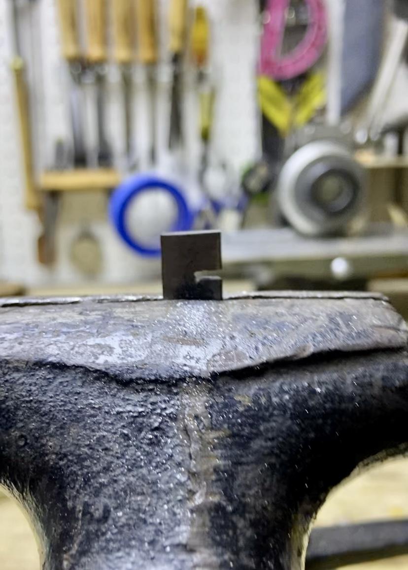

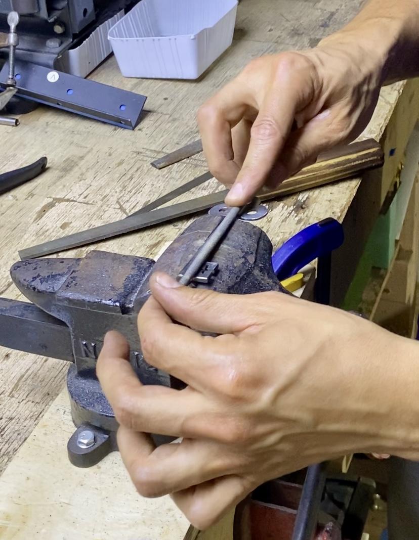

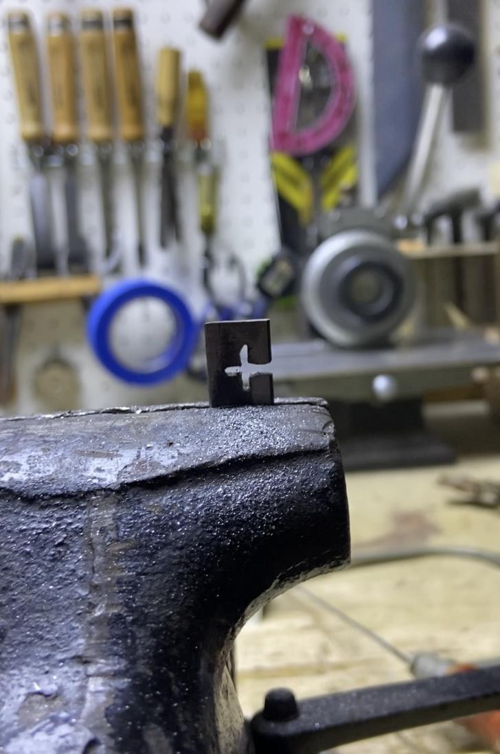

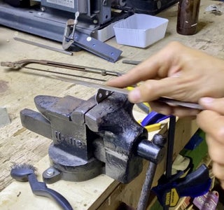

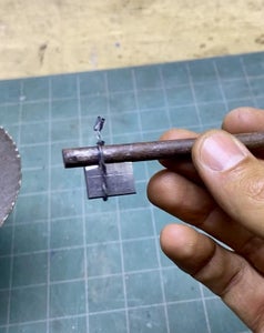

The key itself was already rectangular and the only modification I did was to use a round file on the edge that will mate with the shank (pics 3 & 5). The slot was started with a vertical cut from my angle grinder, followed by a hacksaw and file work. Lots & Lots of filing (pics 11-14). You can do whatever design you want for the slot but more intricate designs take more work. If this is the beginning stages of a functional key (hmm...), keep in mind where the associated lock travel path will be.

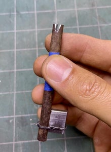

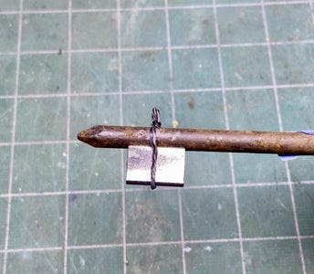

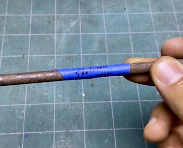

For the shank, I cut the nail head off and cut to length using my angle grinder. It was very rusty, so using some sandpaper, I smoothed it out (pic 9). I cut a notch for the head to slide into, as well (pic 6).

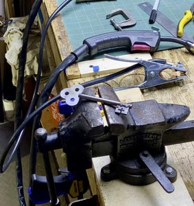

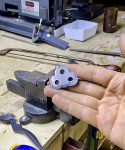

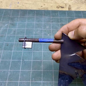

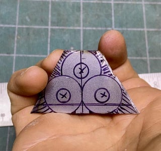

The sheet metal was measured & sketched out using a sharpie and some spare washers to get all the round shapes. I marked where the cuts would be. Using a punch and a drill, I removed the rounds parts and the outer edges were molded with the angle grinder, hacksaw, files, and sand paper.

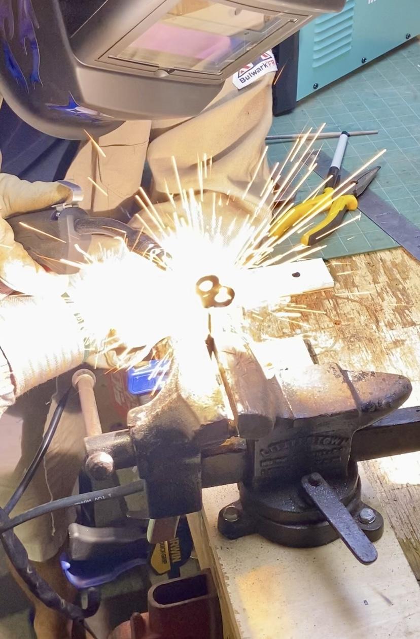

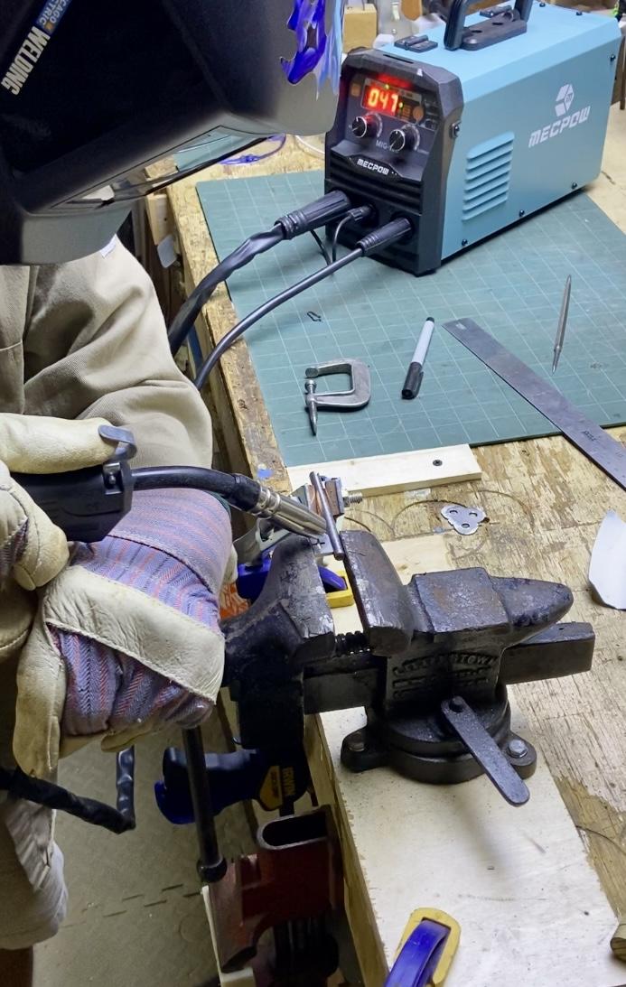

Using my welder's MIG function, I set the voltage to ~50% and amperage to 047 using 0.8mm flux core wire.
I tacked the key to the shank followed by the head to the shank.
Be careful to ensure the key and head are aligned. I almost make that mistake and it could have be discouraging.
I cleaned up the welds and smoothed the key as a whole. I didn't go too wild getting this thing smooth, in fact, I wanted to leave it scuffed to age it with some India ink to give it a weathered appearance.

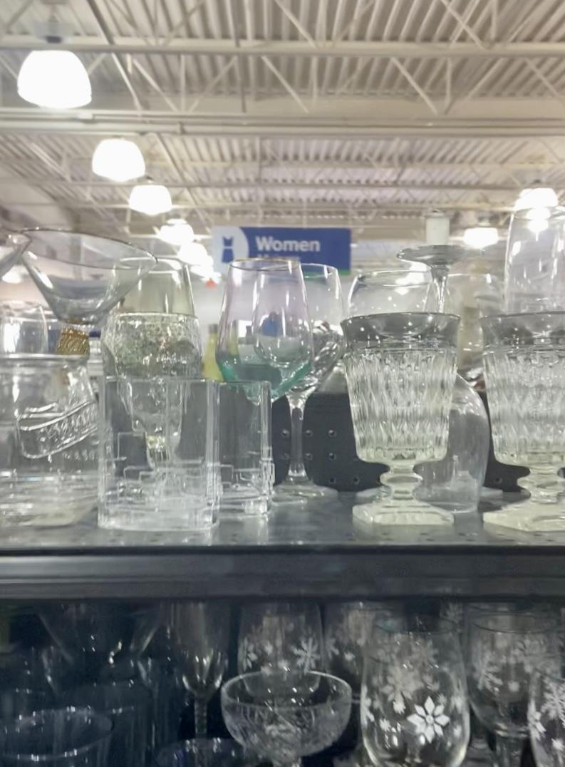

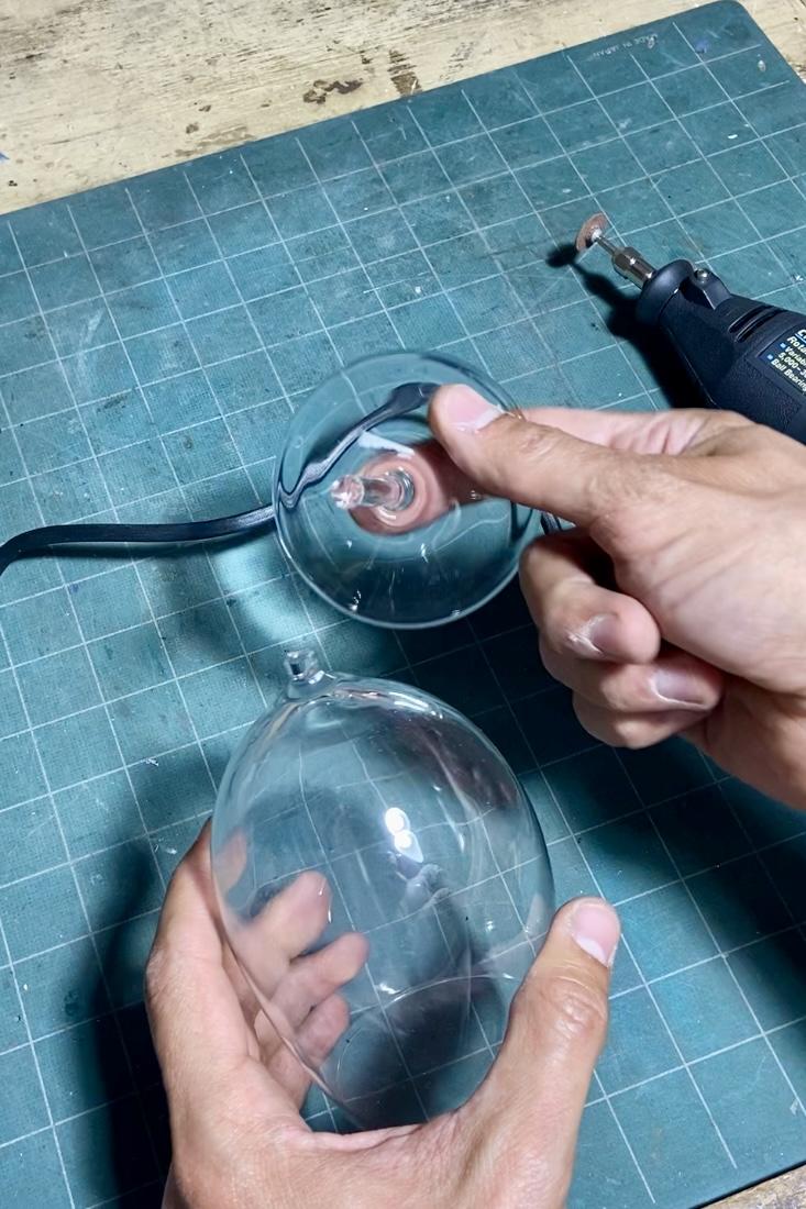

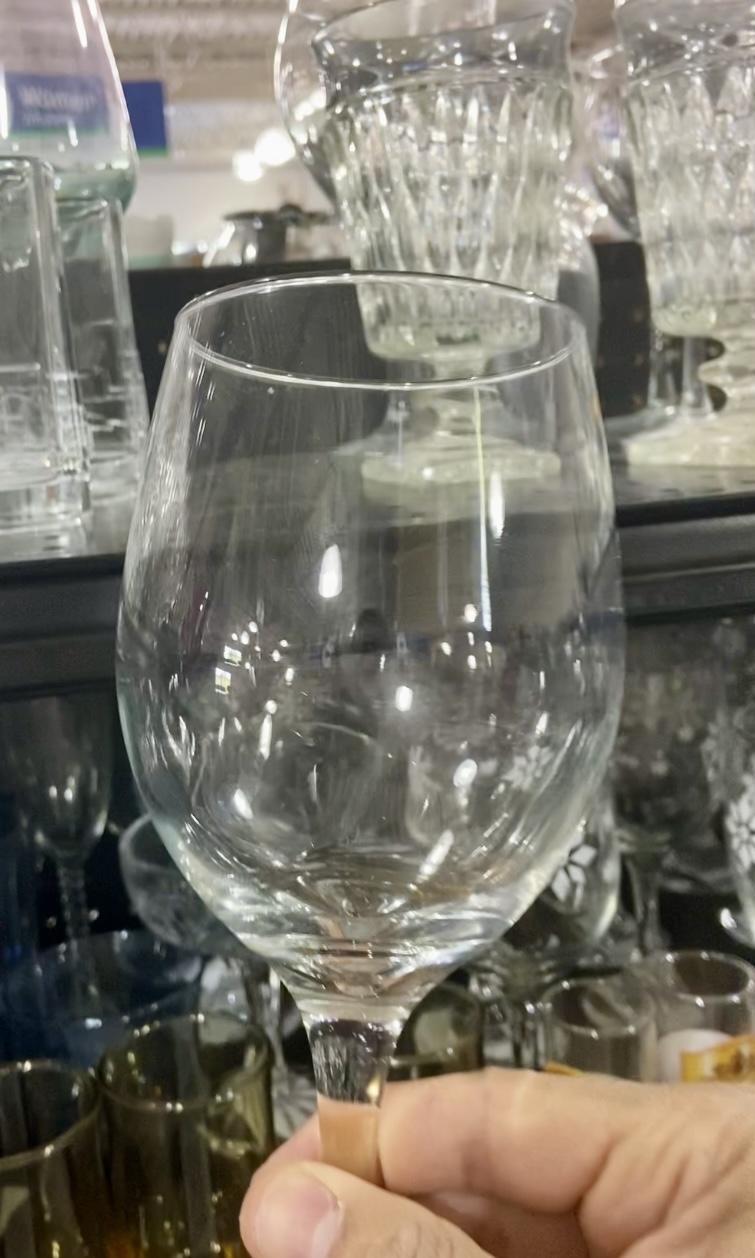

During one of my trips to the thrift store, I often pass by the plethora of glassware. While passing an absurdly large margarita glass, I thought, "If that were a wine glass that...would make...a cool cloche!!"

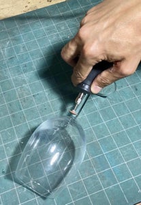

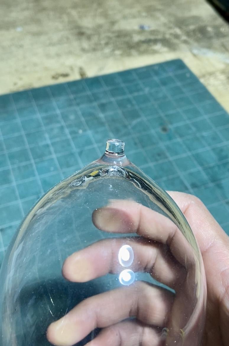

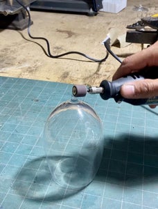

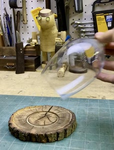

Not seeing one, I grabbed a "regular sized" Cabernet wine glass (pic 1) for 2 dollars and got out my Dremel (pic 2).

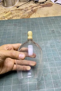

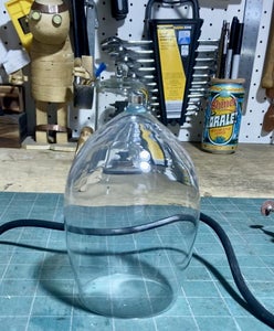

Using a grinding wheel, I cut the stem of the glass off and it snapped off rather clean (pic 3). I cleaned up the sharp edges and thought about how to make the handle (pic 4-6).
My first thought was to use a torch to "bubble up" the excess glass. I didn't leave enough and also my equipment and skill set would not make that happen very easily, I am assuming.

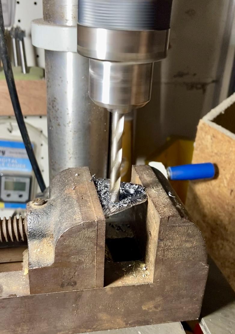

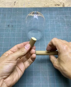

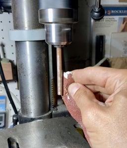

Next idea was to make a wooden knob with a corresponding hole that would fit the tip of the glass. I cut a dowel to an appropriate length (pic 7) and drilled a 5/16-inch hole in the center of the dowel. I then stuck it on a spare rod to chuck it into my drill press . In hindsight, a lathe would be better but a drill can accomplish the same thing as seen in pic 8.
A couple of minutes later and my knob is complete and I glued it into position with some E6000 adhesive. The roughness of the sanding after I cut it will help the adhesive "bite" into the glass (pic 9).
Another idea I had to make a "handle" was to obtain a diamond cutting bit to make a tiny hole where the stem is. That way a looped rope could be added to act as the handle.

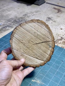

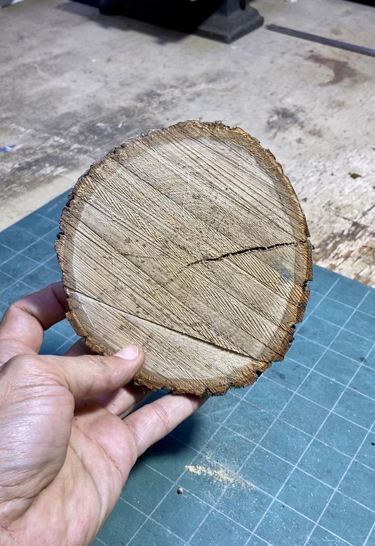

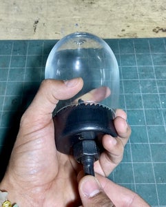

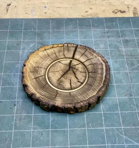

For the base, I wanted something rather rustic. I took a "cookie" from some scrap firewood I had outdoors (pic 1) and found a corresponding hole saw bit to drill a recess (pics 2). Mine used a 64mm or 2.5-inch bit (pic 3). I didn't go full engineer to find the center but rather just eyeballed it where I thought was close enough (pic 4), or should I say, "cloche" enough......nothing?! Ok moving on.
I noticed that this bit made for a tight fit and what I did to combat this was to re-drill but quite loosely. This way the bit would "chatter" a little bit to widen the recess and that worked out well for this build (pic 5).

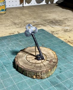

A classic ME move is to burn the surface in Yakisugi style and that is precisely what I did. A stain or finishing oil could also be an option to make the wood pop.

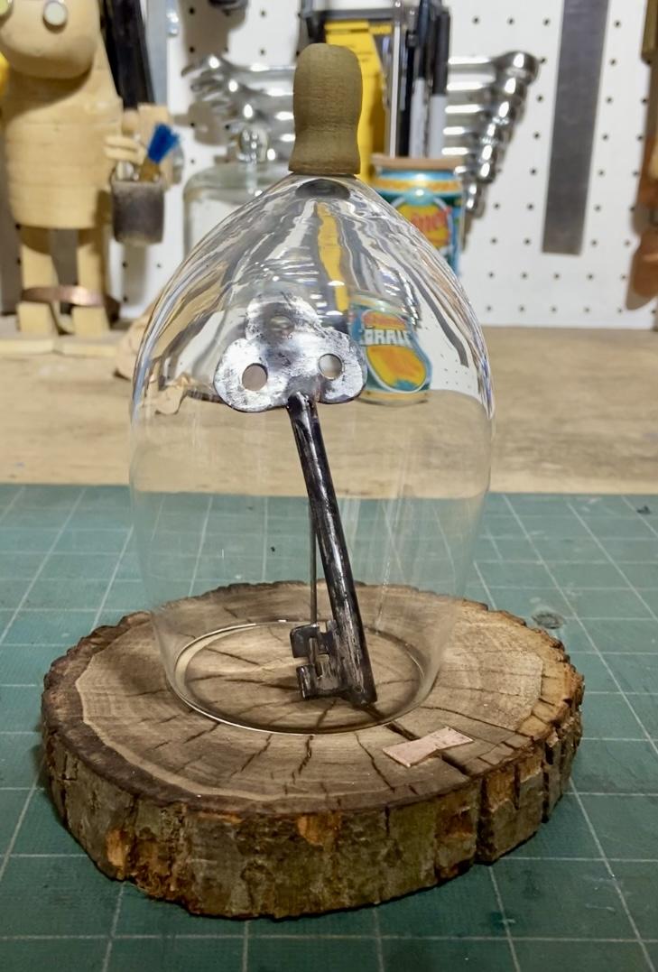

Lastly, I took a piece of scrap metal and jammed it in the wood to give the key something to lean on. I also noticed my base splitting so I made a copper bowtie to keep it from fully splitting in half. You can see them both in pics 7 & 8.

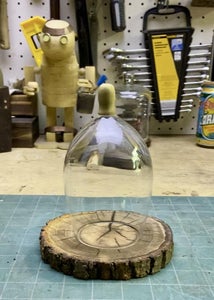

Now it is time to display this project and behold its glory!
