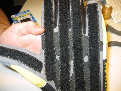

Step 2: Decide on Your Velcro Layout
Pretty easy step, just figure out how you want to attach your Velcro to your glove. I decided that for simplicity I would cut the Velcro in 5 pieces, one for each finger and then sew those on. You can use whatever style that looks cool to you.
Step 3: Let the Sewing Begin!!
This step is pretty obvious, you want to sew on your Velcro strips you made.
My process for this is taking the strip and pinning it at the top, and then working my way around the perimeter of the Velcro. If you know how to sew than this will just take time, if you are unfamiliar with sewing ask a friend it is super easy to learn an easy stitch like this.
Now it just takes time, once you are in the sewing groove this will take roughly 3 hours to finish one glove. But don't get hasty, taking your time to make a nice stitch is better than having a sloppy hold; remember this is holding a protection device on!
Some precautions: The needle is sharp don't forget it! Also try to make sure that you only get one side of the glove and not both as you will not be able to put your hand inside. More obvious precaution, DON'T put your hand inside the glove while sewing!
