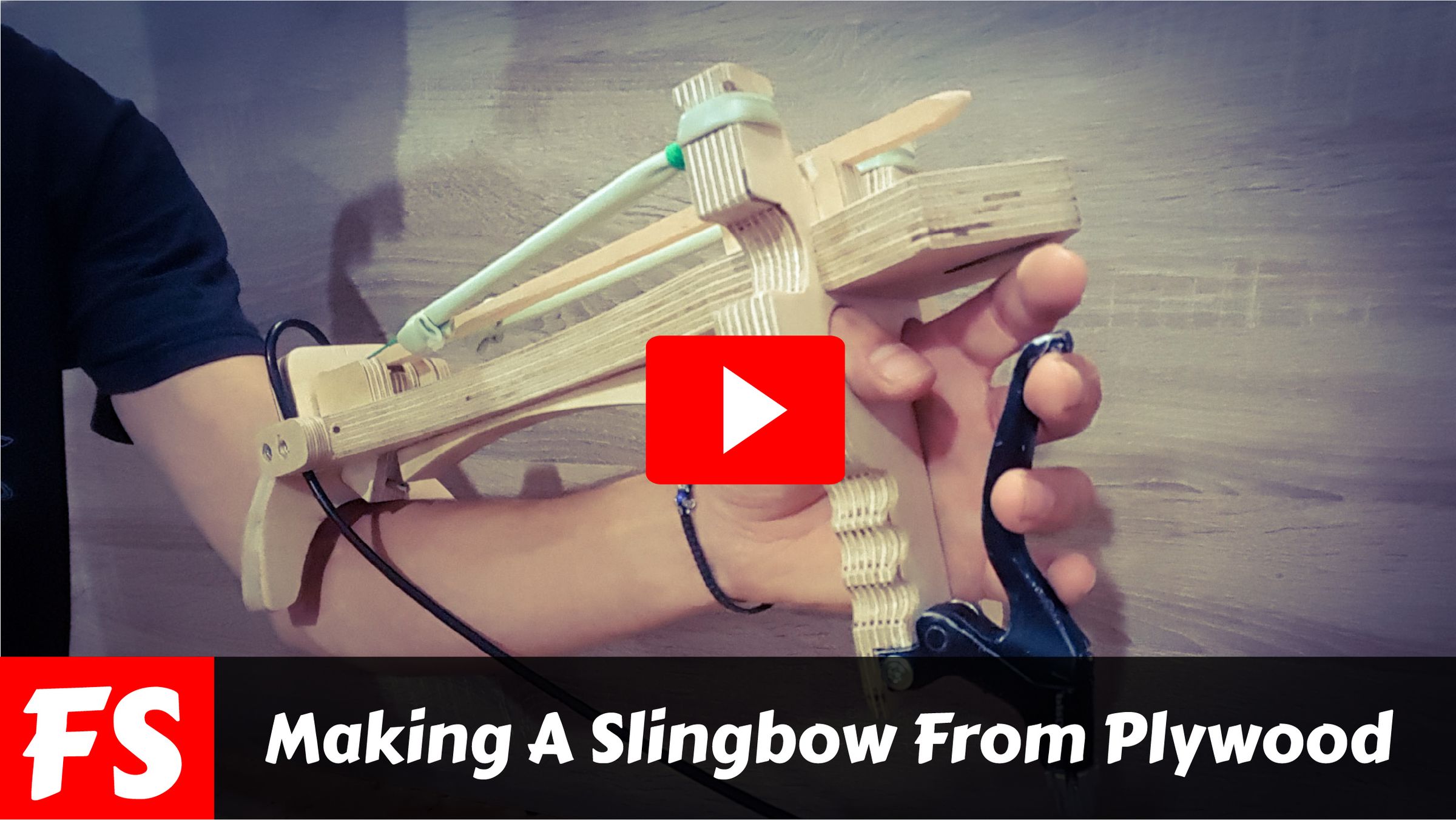

Step 1: The Handle (Part a on the Plans)
The first thing to do is to cut out the handle. Start by attaching the plan on a piece of 20mm thick plywood and cut it out on the band saw. A scroll saw works as well as the band saw and provides more accuracy.
With a 28mm wing bit start the hole on the handle and finish it with a jig saw.A 25mm hole is also needed to be done for your finger.
Make any adjustments if needed on the shape using a rasp and files. Smooth it with sandpaper.

Step 3: The Base (Part B on the Plans)
This is the base where everything else is going to be attached on. So cut it out of 20mm plywood and screw it on the handle with two 50mm screws and some wood glue. Do not forget to predrill so the plywood does not split.

Step 5: The Trigger
The trigger it self is a bike break lever modified a bit so it can be attached on wood with a screw. A hack saw is used to modify it. Also a notch at the bottom left side of the handle will keep the trigger in place and bring it closer to your hand for easier access.
Step 6: Trigger Mechanism and Parts (Part C on the Plans)
The triggering mechanism is pretty simple and it is consisted only by two pieces of plywood. The idea behind the trigger mechanism is also very simple and basic. The two pieces are attached on the frame and the tension from the rubber band holds them tight together. As you pull the break lever you actually rotate the bottom part of the mechanism and force it to release the other part which also rotates and releases the string and the rubber bands.

Step 8: Attaching the Rubber Bands
Pretty straight forward. Attach the rubber bands on the slingbow using some rope. keeping them stretched helps a lot to make them tighter and more secure. If you work alone like me then a clamp will help you keep the stretched and also will set your both hands free.
