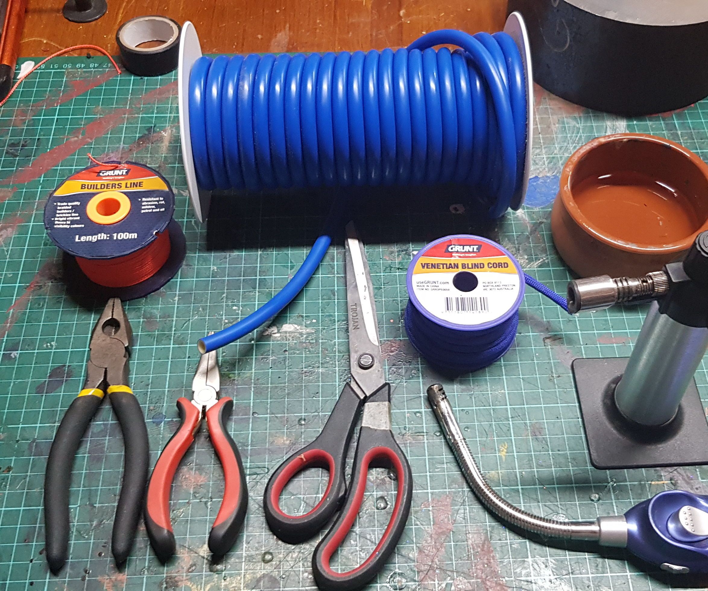

If you are interested in just making the bands for your RBG, please follow this link.
