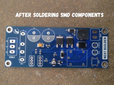

Step 3: Solder SMD Components
It's very important to first clean the PCB with some isopropyl alcohol. Then apply solder paste on the pads by using a solder paste syringe. It's a very good choice if you're using stencil to do this work. Place parts with tweezers making sure that resistor, diode, etc. are properly aligned. I like having a second board with no paste on it to see the alignment dots.
Now you have many options to cook the PCB like a hot air soldering gun, Hot plate, reflow oven, etc. I have used my Miniware MH30 hot plate to solder the PCB. Set the temperature according to your solder paste melting point and place the PCB on the hot plate.
It is important to look at the reflow profiles of all your components, to see how long you can heat your components for, and at what temperature. I usually just "wing it", and heat them at about 250C, for about a minute. You will see the solder melting, and the components being soldered into their respective places. Now you can turn off the hot plate and let it cool down completely.

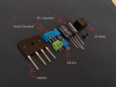

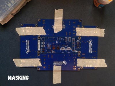

Step 4: Solder Through Hole Components
The PCB has some through-hole components like- Capacitor, Bridge Rectifier, Screw Terminal and Relay.
First place all the components to it's place and mask it using masking tape. Now tun the first leg of all components for balance and then solder it one by one. To do this Soldering process, I'm using my Miniware TS80P Soldering Iron.
Once you have completed the soldering process it is important to remove the flux from PCB. Spray a small quantity of IPA (Isopropyl alcohol) Solution and clean it with cotton. Now the PCB boards are ready to use.

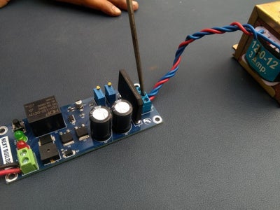

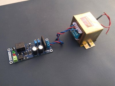

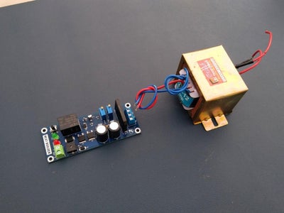

Step 5: Transformer Connection

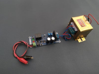

The transformer has three wire, Red-Blue-Red which stands for 12-0-12. Simply connect these three wire to PCB input Screw Terminal by using a screwdriver. PCB has already marked three polarity 12-0-12 for easy connection.

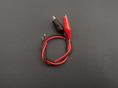

Step 6: Charging Clip
To create the charging clip, attach crocodile clips to silicone wires, ensuring a strong and secure connection. Use a red wire for positive (+) and a black wire for negative (-) to avoid confusion.
Once the clip is ready, connect it to the PCB’s output screw terminal using a screwdriver. The PCB is already marked with + (positive) and - (negative) signs. Securely connect the black wire to the minus (-) terminal and the red wire to the plus (+) terminal to ensure proper polarity.

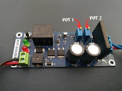

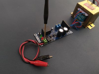

Step 7: Calibration
To ensure proper charging, you need to calibrate the circuit by setting the charging voltage and auto cut-off voltage.
  1. The first potentiometer controls the charging voltage. Slowly rotate it clockwise to increase the voltage and counterclockwise to decrease it. Adjust it according to your battery's required charging voltage.
  2. The second potentiometer sets the auto cut-off voltage. Turn it slowly clockwise until the green LED turns on, indicating that the cut-off point is set. This ensures the charger stops supplying power once the battery is fully charged, preventing overcharging
With proper calibration, this smart charger will efficiently and safely charge your battery.

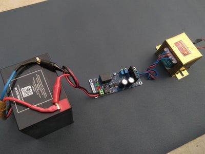

Step 8: Testing
Before testing, ensure all connections are secure. Connect the transformer's AC input wires to a 220V power source, ensuring proper insulation for safety. Attach the charging clips to the battery, checking the polarity, red to positive (+) and black to negative (-) to avoid damage.
When charging begins, the red LED will glow. Avoid touching exposed wires during this process. Once fully charged, the green LED will light up, and the buzzer will sound, indicating completion. If the charger needs to be restarted or a fault occurs, simply press the reset button to restore normal operation.
Never leave the charger unattended. Use insulated tools, keep it away from water, and avoid charging damaged batteries. After charging, disconnect the power to ensure safety and longevity.
